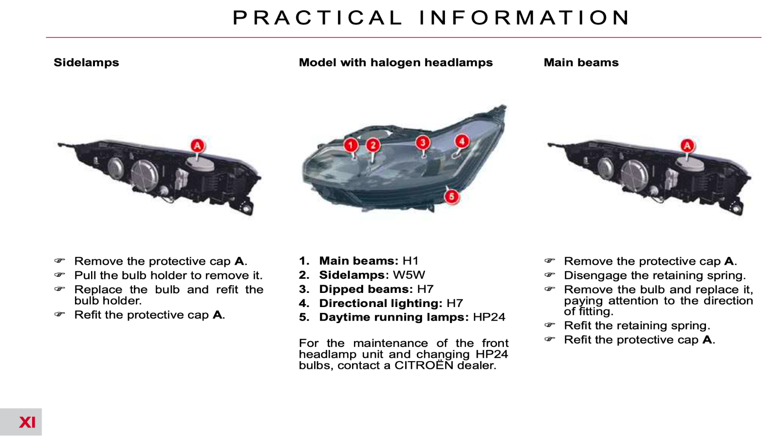

Hmm, well I deffo have halogens because I have replaced an H1 and an H7 - but in the dashboard menu there is an item to enable/disable directional headlights.
This is in the manual
I wonder if this means lights that illuminate when the indicators are used? I have not driven the car at night yet LOL

Directional headlights will be the cornering lights that illuminate into the road junction or corner you're turning into ????
- x 6946
Re: Preparing C5 X7 for trip to UK
Yes I think that's where the confusion lies.
Directional lighting is only for Xenons not halogens.
Separately, each type of headlamp (xenon or halogen) also incorporates a version of cornering lighting, but in the manual it is an ambiguous and ill-chosen term as it is not directional, it is static! All it does is activate the outer corners of the headlamps when at junctions or going round bends at lower speeds, they have fixed positions and do not move.
So we generally refer to these as the 'Angular' or 'Cornering' lighting.

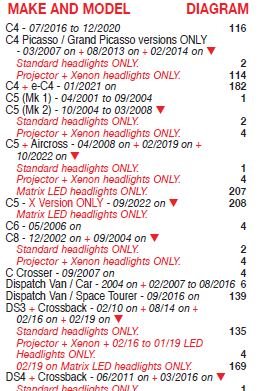

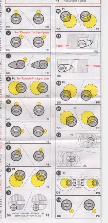

How strange......
The very common (at least over here) Eurolites beam deflectors (available in all the usual motoring places) gives details of where to put the beam deflectors on RIGHT HAND DRIVE Citroen C5X7 with 'standard', 'projector + xenon', and 'LED matrix' headlights. Seems odd that you don't have to do anything for LHD cars......
