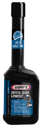

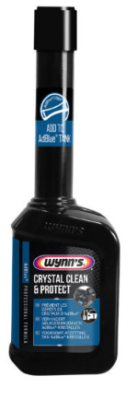

I would have the injector taken off and examined to see if it is full of white powdery crystals. If so, that will be a cause of the blockage. It can be cleaned up and replaced. I strongly suggest you get some Adblue anti-crystallisation into the tank and use this regularly when filling up the Adblue tank - is prevents crystallisation in the first place and can help breakdown existing deposits in the system:
Wynne's do one:
