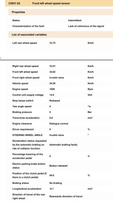

I've run the global scan.

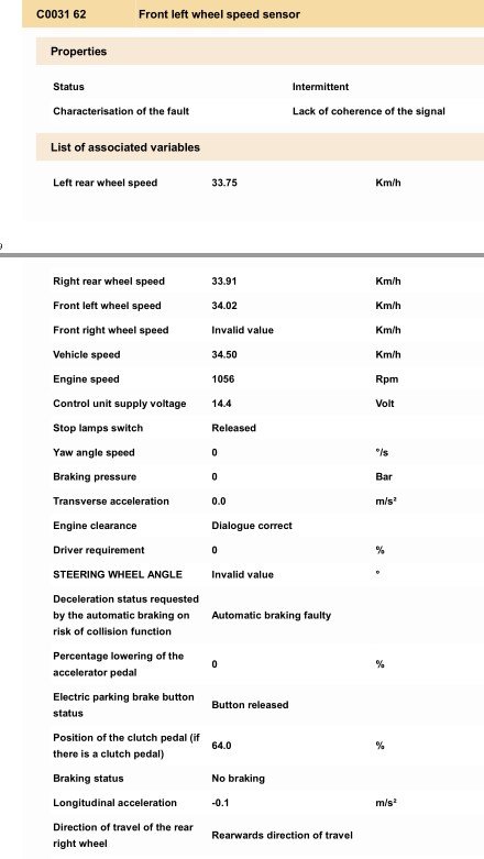

For C0031 62 Front Left Wheel Speed sensor, the list of associated variables shows "invalid value" for the front right wheel speed. Control unit supply voltage 14.4 volt.

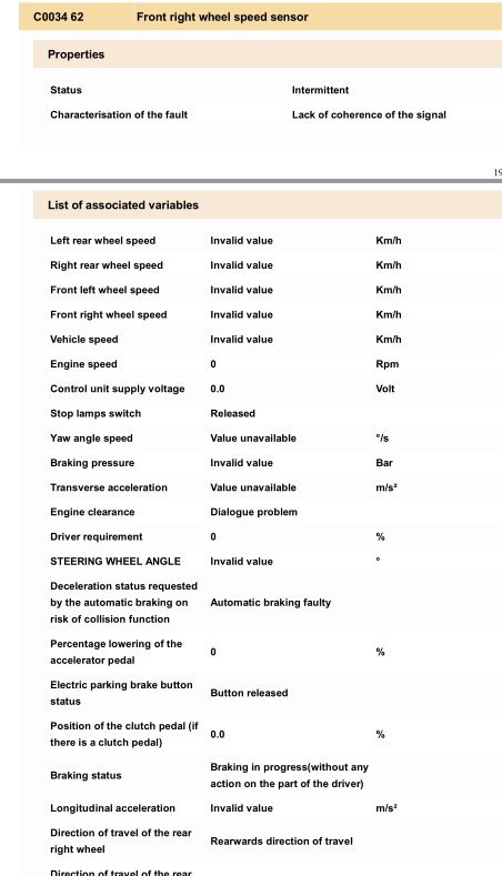

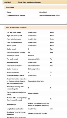

For C0034 62 Front right wheel speed sensor, the list shows "invalid value" for all 4 wheels. Control unit supply voltage 0 volt.
I can send the saved pdf of the scan if that would help?
Many thanks

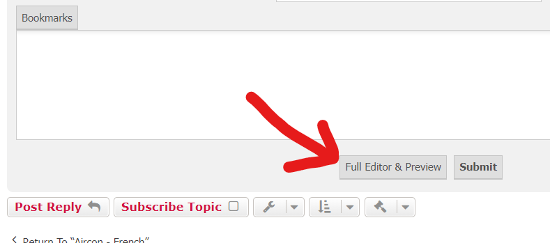

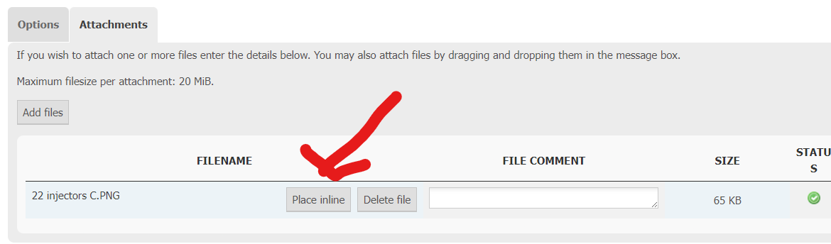

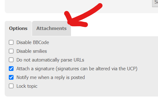

@dram773: No, just take a screenshot and upload relevant images to the forum directly if you want to:
Instructions:
Instructions:
| 1) Use Full Editor & Preview Button | 2) Click Attachments Button |
| Click Add Button to Browse PC or Phone for Images and Upload | Click Place to put the Images in Your Post |
dram773
- Posts: 60
- Joined: 30 Apr 2024, 10:41
- x 6
Re: Peugeot 308 SW (2017) ABS/ESP faults
Here screenshots attached.
Many thanks

- Posts: 12596
- x 1489
Next you want to clear the faults, and then see which comes back. Possibly the RH sensor has thrown in the towel and caused the others to go haywire.

There's clear indication that at your front right sensor is not getting any power - so without that can't send any data back to the ESP ECU. Whether the sensor itself is faulty or the supply to it is what needs looking at and certainly I would be checking the connection plug at the ESP ECU to see if that has been removed and not put back on properly. Has any work been done on the vehicle lately - brakes or wheels or anything else in that area?
