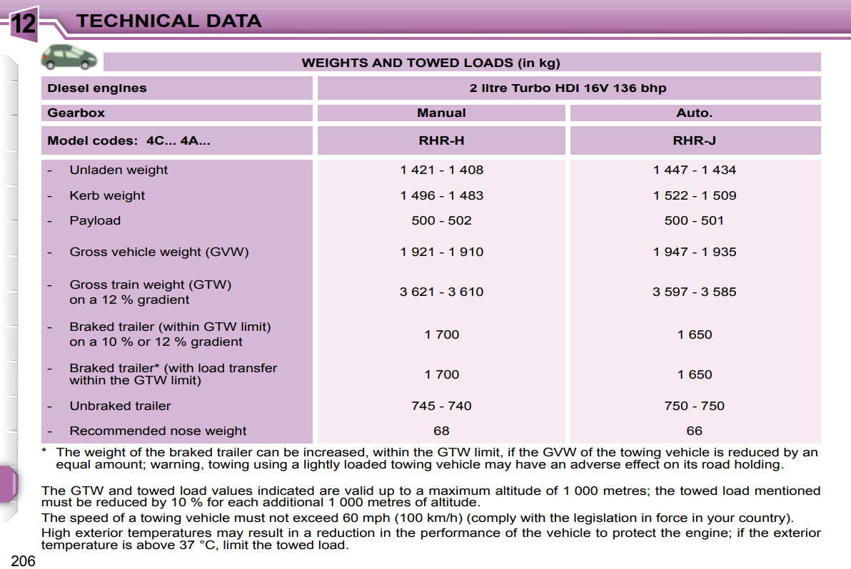

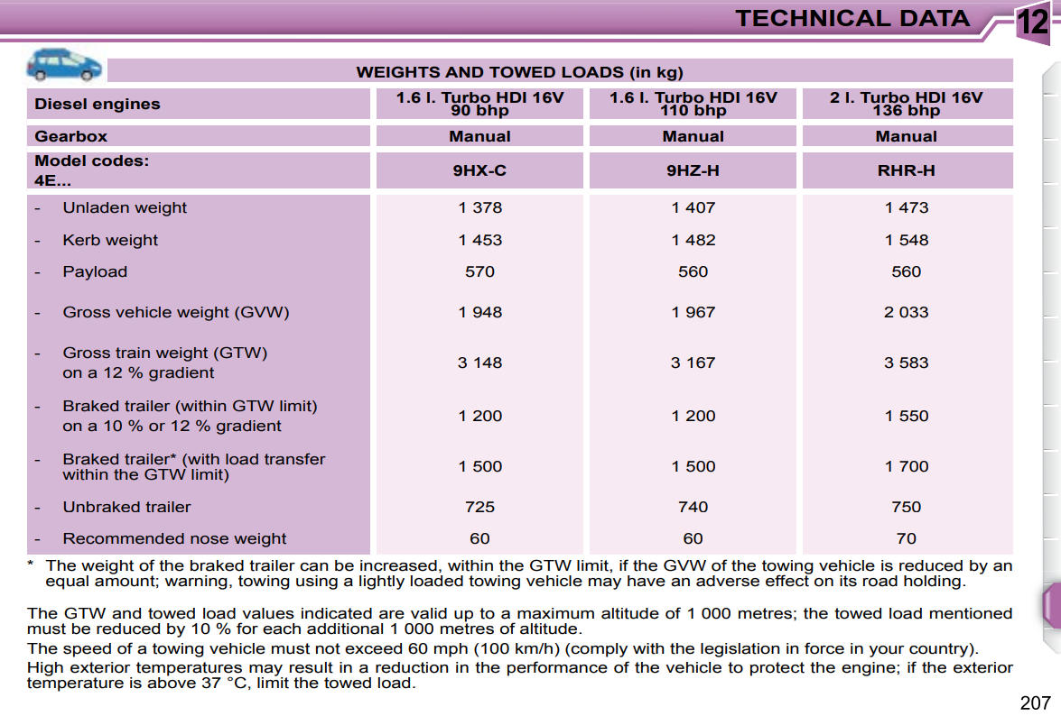

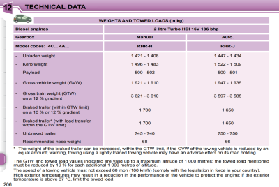

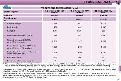

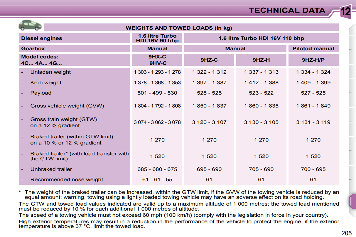

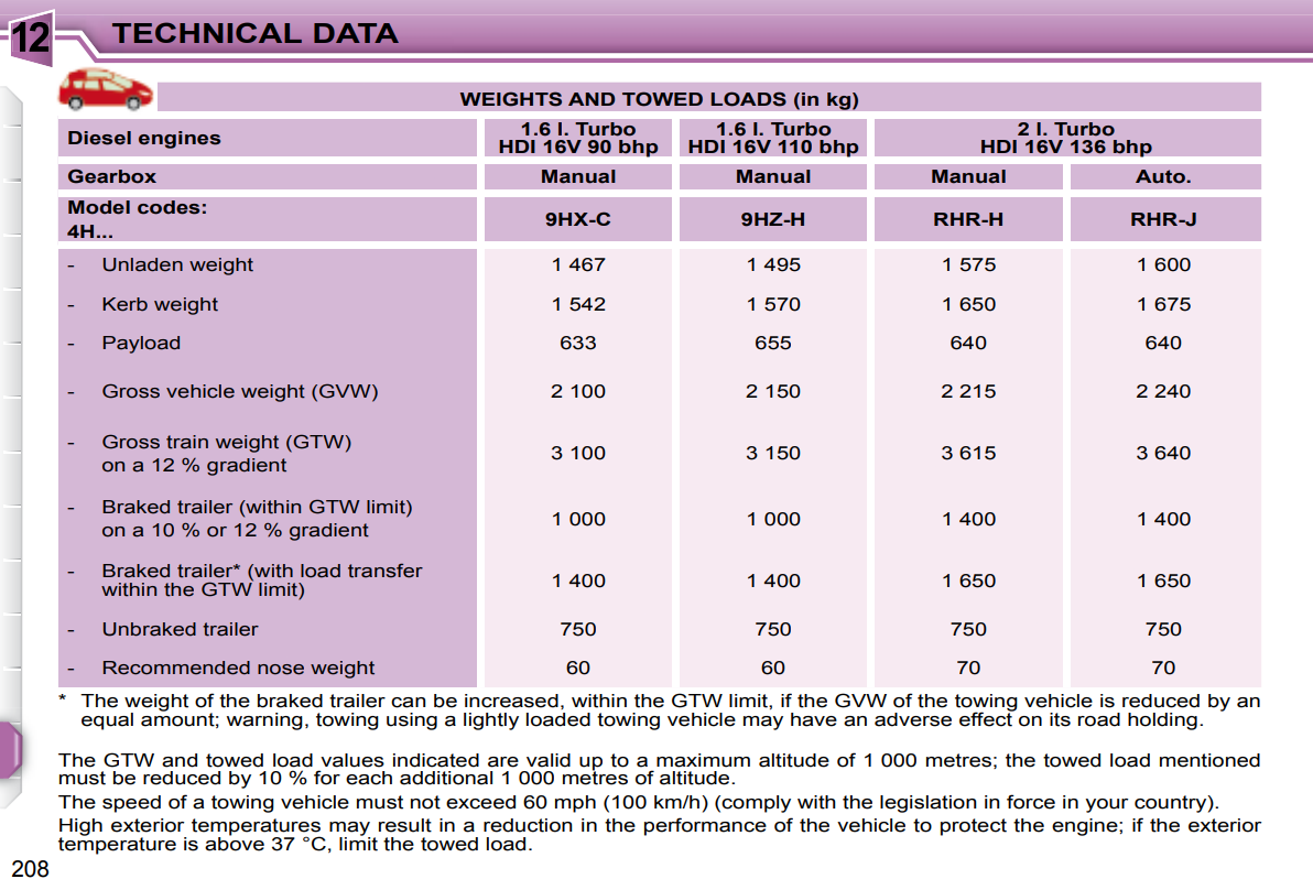

From the Technical Section of the Manual:
