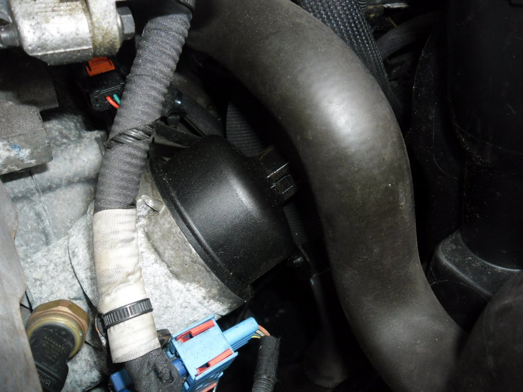

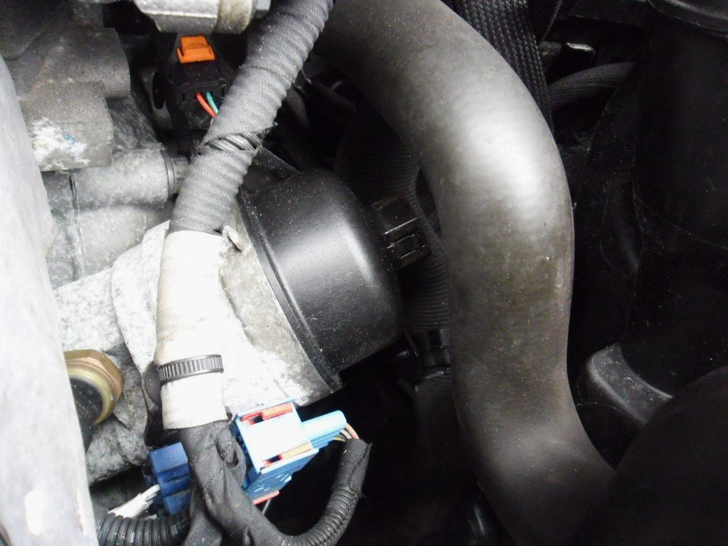

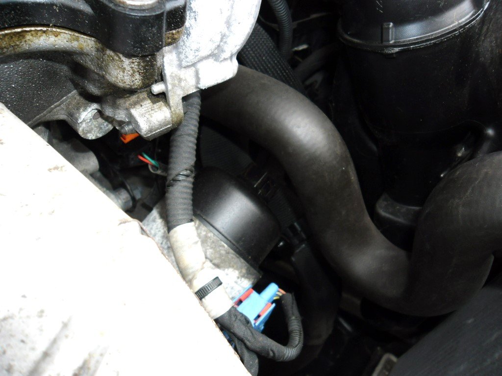

Re: Citroen C4 AirCon
This item ( Oil filter cover, I don't know) has got an electrical socket on the top, but there is no sign of any wiring anywhere near it. Does anybody know if there should be something plugged in there and if so where is it likely to be. I don't know if there could be any connection with my aircon issue.
The oil filter cover is undone using a socket, hence the top of it is shaped for the socket and the 2 lugs on the sides of it are to help hold the socket on it. You should check the socket size but it is usually 27 mm and done up to 25 Nm, a 6 point socket is preferable. I have yet to see on any of our Citroens an electrical connection on the filter cover.
Thanks for that info, Paul, especially the oil consumption. I'm not sure what I am looking at in the photos, it might not be the oil filter cover, but it definitely has an electrical connection on top. I am wondering if some higher spec models might have some sort of anti oil pollution system in there ( you might remember the old idea of a magnetic sump drain plug) or something to measure oil viscosity before flagging up the need for an oil change. As far as the aircon is concerned, since the clutch is permanently engaged ( ie spinning all the time) I wonder if I should get a new after market compressor ( my car is 2013, so I don't want to pay Mr. Citroen price for a new compressor) before looking for further help from the Citroen dealer. Any thoughts on that idea?
