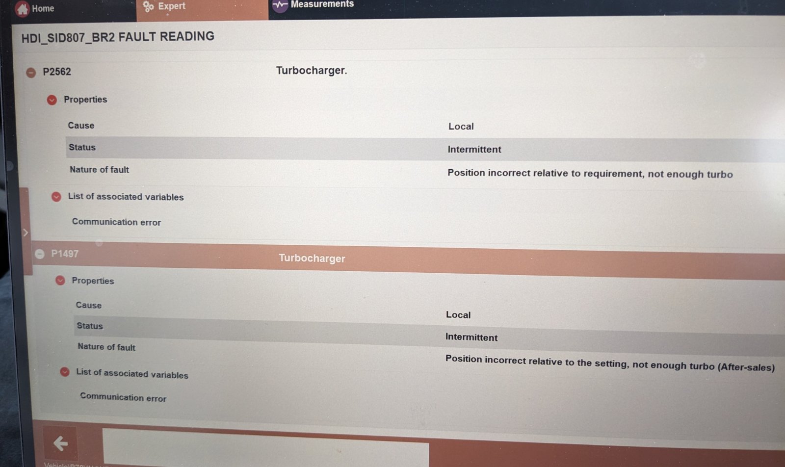

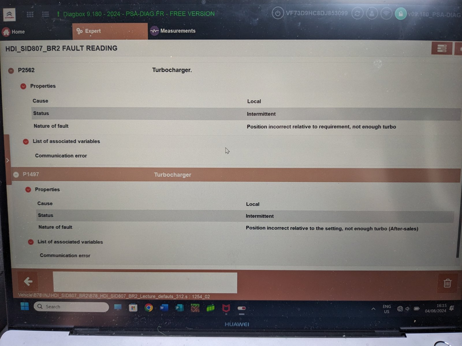

My friend had his C4 Picasso and we suspected that it may be a faulty sensor.
The faults were cleared, but the same faults are now still there when I've scanned the car for him because he doesn't feel the pulling power he is expecting when setting off.
The fault codes are;
P2562 - position incorrect relative to requirement
P1497 - position incorrect relative to requirement (after sales)
Can you give anymore details about the fault codes?

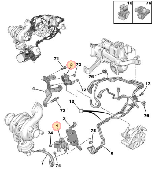

I'm listing both valves for reference.
(1) Turbo Solenoid Valve, part: 1618PE, £83.96
(2) EGR Solenoid Valve, part: 1618KG, £37.58

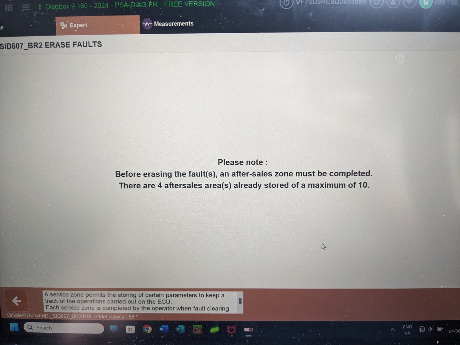

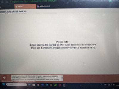

Is anyone able to help clearing the faults on Diagbox?
I'm trying to clear these faults - but it's saying;
"Before erasing faults, an after-sales zone must be completed.
It then takes to to another screen to input the current mileage, but then it says fault erasing failed.
I'm running Diagbox 9.180
I don't have issue clearing any other faults.
Would an earlier Diagbox version be better? (7.57 or 7.83 etc.)
**EDIT - I've now tried Diagbox 7.57 and it's still giving the fault clearing failed.**
VIN - VF7**************[VIN obfuscated, can be read by forum staff]
Thanks
steveclv
Posts: 189
Joined: 25 Apr 2024, 14:13
x 40
Re: Turbocharger fault codes - C4 Picasso (B78)
Unread post by steveclv »
Didn't see any replies but just found out that if you erase faults from the REPAIR menu then it asks you to record the repair in one of 50 available 'slots' by recording the mileage. You should be able to delete the fault from the main diagnostic screen instead which doesn't record the fact that the fault was cleared.
