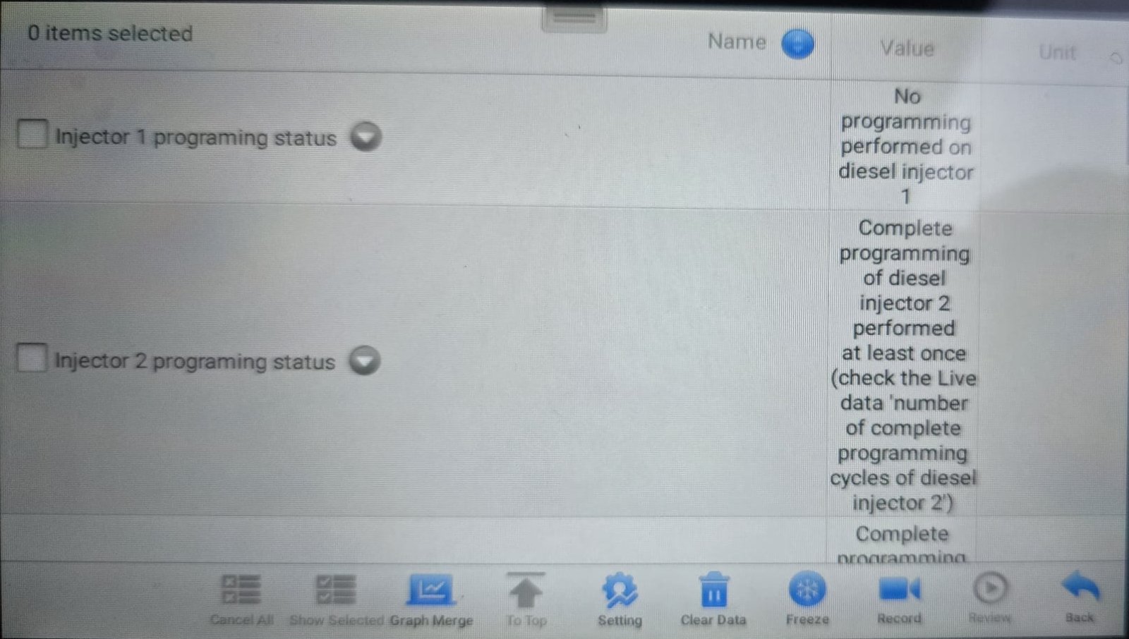

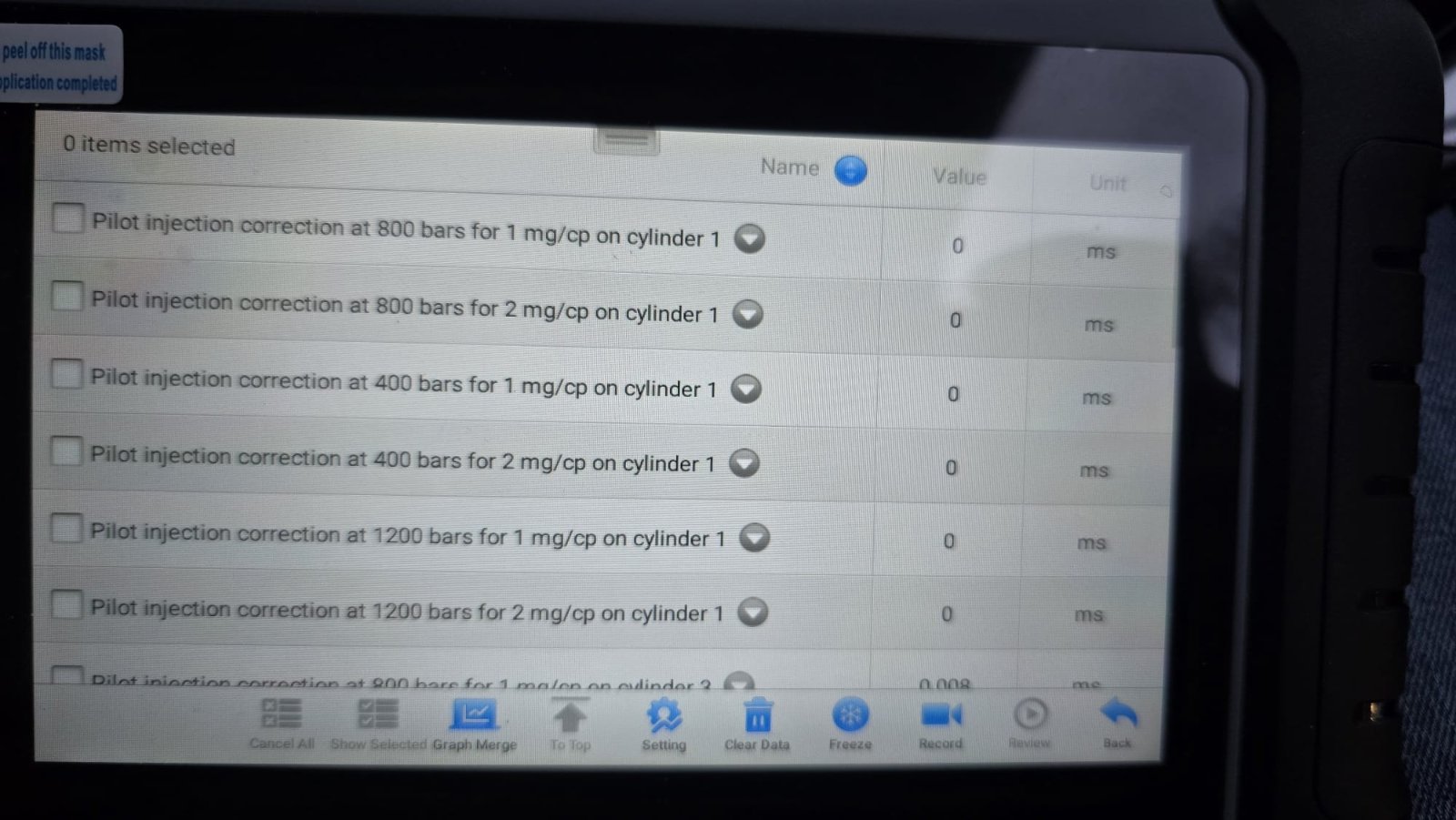

I tried to initiate a reporgramming of the injector, but it doesnt seem to do anything, the count is still at 0 - the others show as 203.
How do i get it to reporgarmme?
Also is it nessasary to update the injector code if everything is running fine?

I thought as much (needs coding). I did manage to do the coding, the main issue now is programming.
The Autel is fully up-to-date.
I did find the programming functions which tell you that its triggered and you need to drive the vehicle between 1600 and 2600 rpm and to lower speed / rpm to not use any pedals.

What do you mean by programming as opposed to coding? Or were you confused by me using the term coding?
The screenshot shows that injector 1 needs programming/coding with the new code. Are you saying that it's now been done?

In the autel, it seems there are 3 steps to replacing an injector.Paul-R wrote: 15 Jul 2024, 16:56 What do you mean by programming as opposed to coding? Or were you confused by me using the term coding?
1. Physical replacement
2. Coding the injector in with the 6 digit code.
3. Letting the car programme the injector it self.
1 and 2 are done. Number 3 wont trigger.

3 will happen in it's own sweet time, it appears to be quite a fussy process, eg the engine has to be fully hot, the road not too bumpy, etc. The screenshot I posted the other day spells out the drive-cycle procedure that is supposed to set it off, but honestly I wouldn't worry about it unless there's a significant driveability problem, or the injector is clacking like a castanet.CrazeUK wrote: 15 Jul 2024, 17:00 In the autel, it seems there are 3 steps to replacing an injector.
Edit - read back better - are you sure it's the same injector that's noisy? I had to do one. Then another.
On my 110k+, 13 year old, the originals have only triggered that a couple of hundred times, so it's not a major part of the setup.

Thanks for your response. I have given up the idea of reprogramming (even testing it for now), although i have been on a few long runs with the car.
To be honest, when it was i nstalled, the car seemed to feel fine. I then thought maybe i should reporgramme it.
Having checked again, i dont think its the injector making the tapping noise, i think it maybe a belt tensioner (a little silver part that rocks back and forth).
