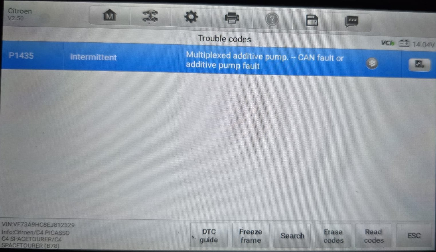

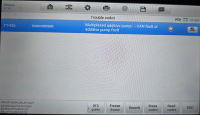

Whilst running the scan, i was checking individual components, and suddenly popped up with a Eolys P1435 error.
Multiplexed additive pump. -- CAN fault or additive pump fault.

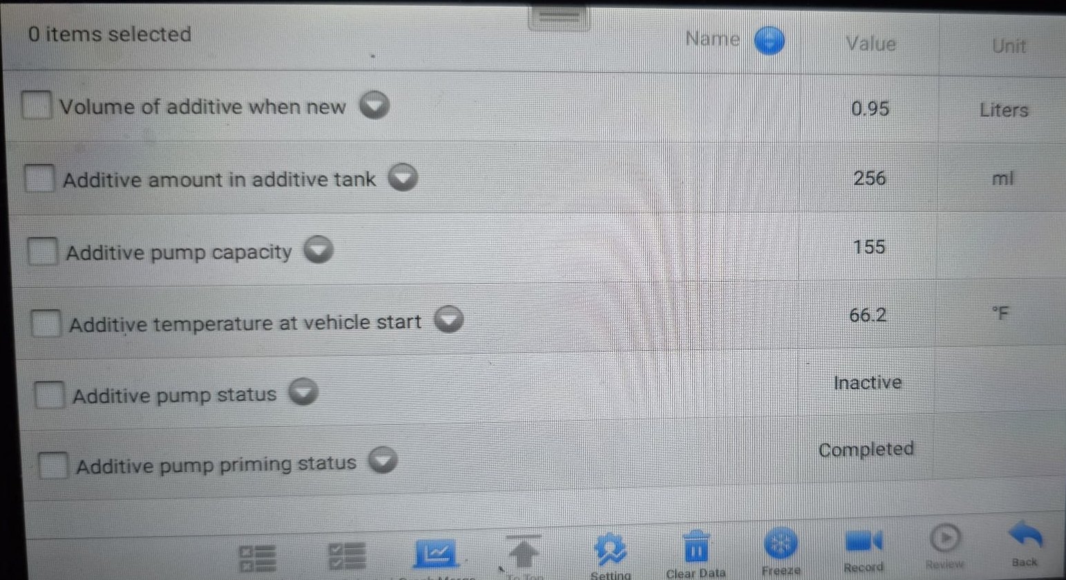

I then ran a test on the pump, and heard a gentle thumping noise.

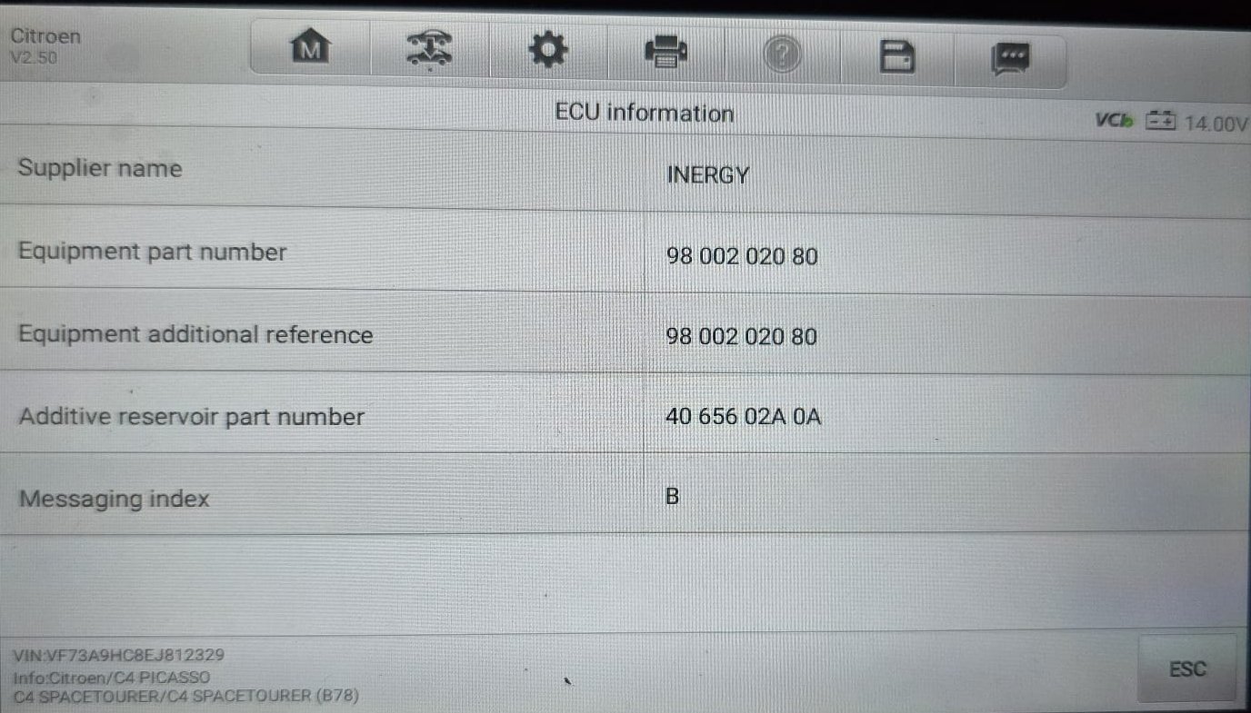

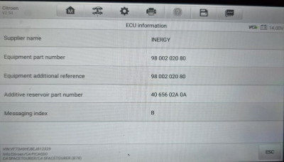

p.s. i have screen shots from the tool showing the part number and quantities.
Additive information
Part information

Error Code
Error Code

It will have Eolys, it doesn't have AdBlue. If it's intermittent, just ignore it till it's really a problem!
x 6948
Re: Eolys P1435 error when there is no tank
Confirmed you have DPF with a an Eolys additive tank. Do not get this mixed up with the SCR system that is a separate system to treat NOx that uses Adblue. They are entirely different systems with different functions.
Your vehicle is Euro 5, not Euro 6, which is why you pay the dreaded ULEZ.
