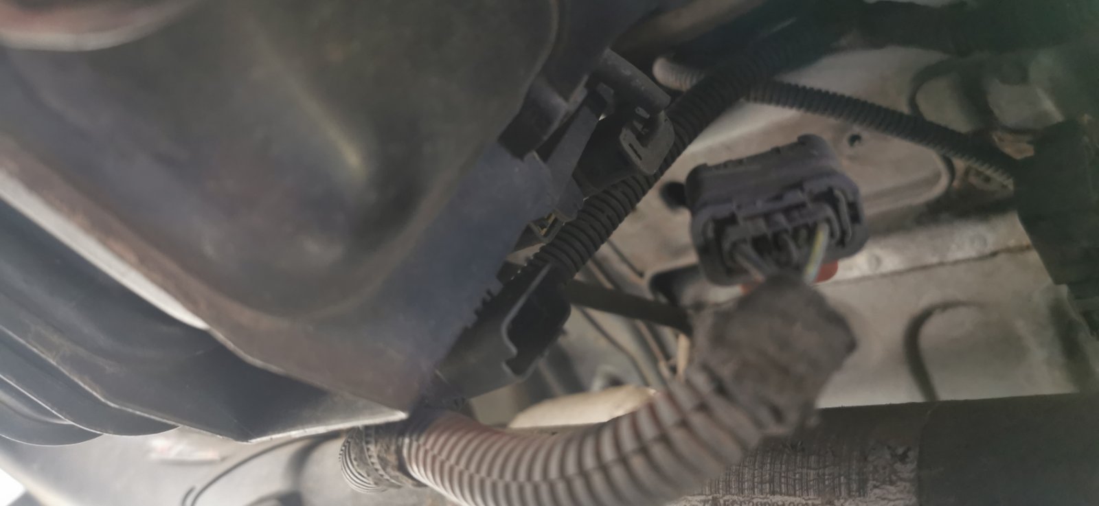

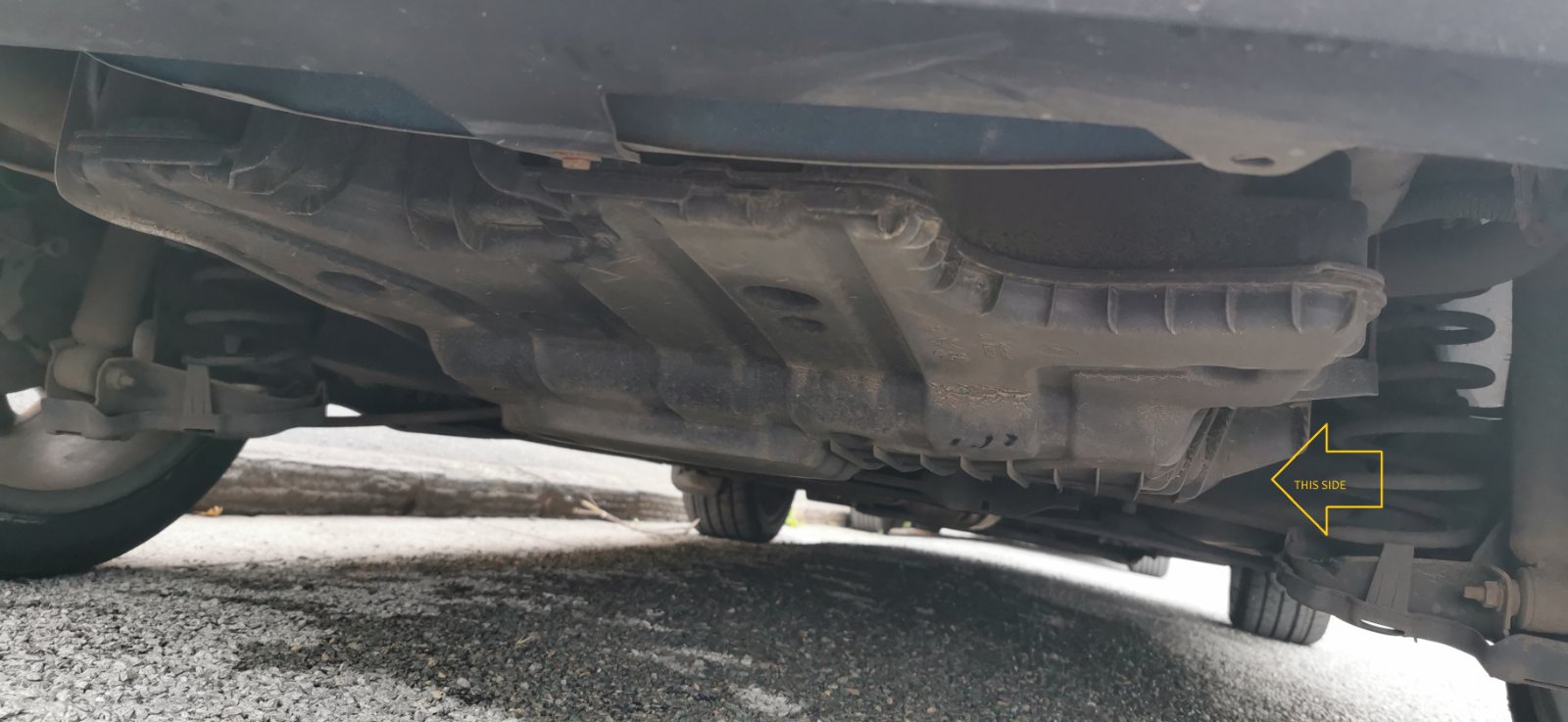

Whilst nosing around my new (to me) 2015 DS4 I noticed there is a connector unconnected to the rear plastic tank which I'm guessing is the Urea tank and not the fuel? Car runs fine and judging by the corrosion on the pins this has been disconnected for a while. Would this suggest there has been an AdBlue delete? It wasn't mentioned by the previous lady owner who was only the 2nd owner. I gather these tanks can be troublesome on this engine.

Certainly looks like the urea tank connector...... result 8-)
