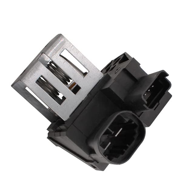

im not sure e.g dont know how to bypass my C3 resistor cos its 2 + 4 wires

Radiator Fan Motor Relay Resistor for my C3… is far from regular relay

So nothing in your fan wiring that's a sealed round/square plastic box with 4/5 flat pins sticking out downwards?
