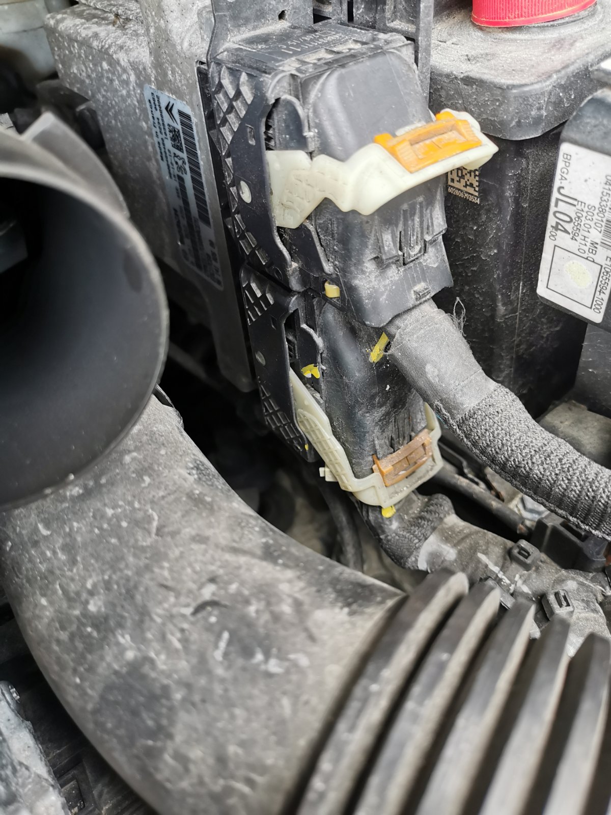

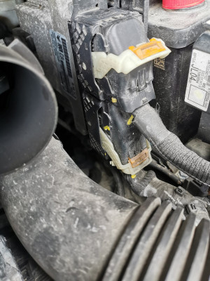

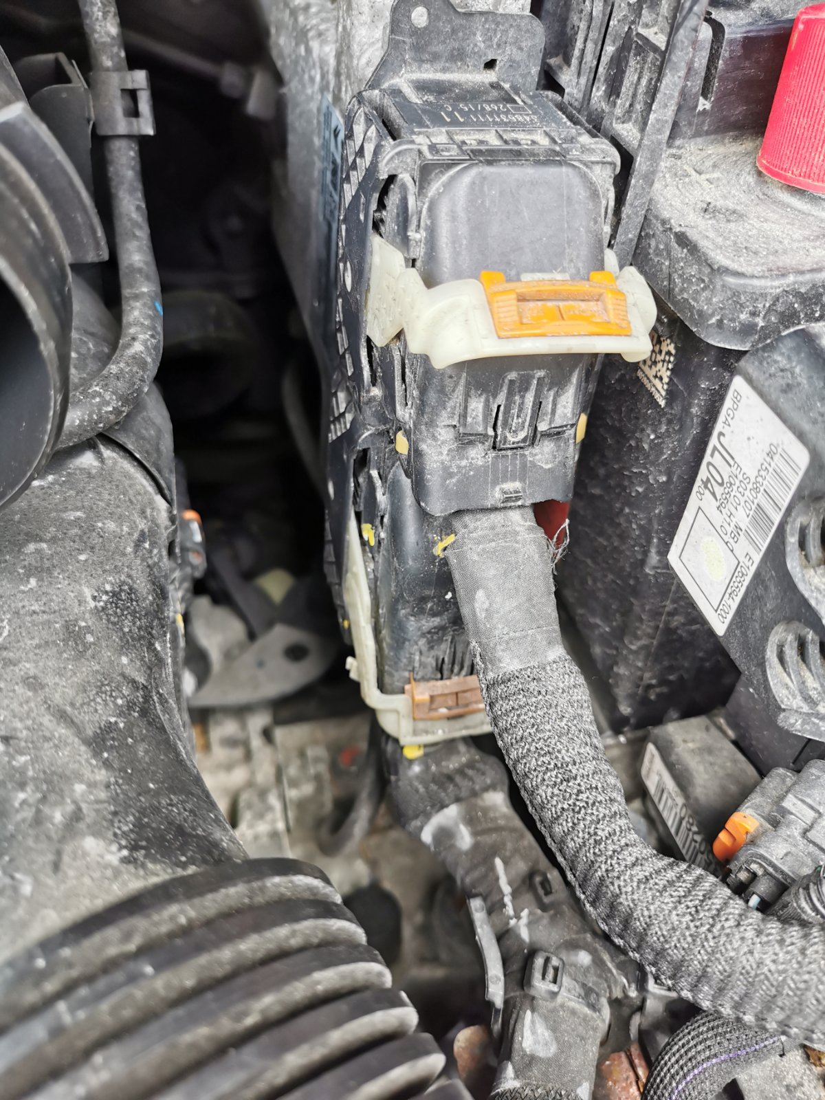

One of the things I had planned to do while the battery was disconnected was pull the plugs into the unit beside the battery and clean any contacts, but I couldnt work out how to get them off so abandonned, didn't want to risk damage. I sprayed contact cleaner into every likely orifice instead.
So, from the attached photos, how to get those plugs undone? The top one is partially released, the bottom one still secured. (the red thing is just a cap I pushed over the naked battery + terminal to avoid accidents) Slide orange bit down, push the middle of the black bit and the white clip pivots up, but only so far. What next?

The power up fault is almost certainly the BPGA battery protection unit. The one you are trying to unplug is the engine ECU however.... the BPGA is directly in front of the battery.

Thanks. Probably best I couldn’t undo it then. I will have a look in daylight tomorrow when/if the rain stops. I am sure you are right so it looks like a replacement BPGA is what I need if it’s still causing problems.
