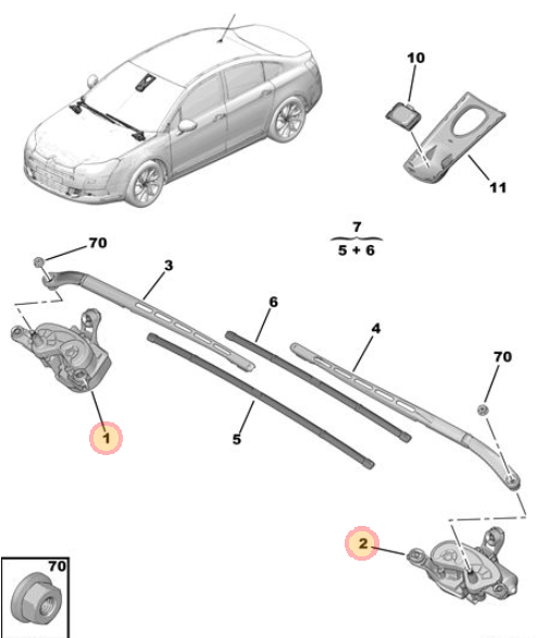

Yep, not cheap
(1) Front Wiper Motor (Right) Part: 6405LA, £464.89
Front Wiper Motor (Left), part: 6405LE, £464.89
VAT inclusive direct from Citroen.
