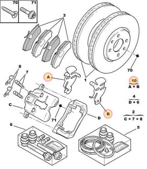

Hi. Real numpty question... Are the anti-vibration screws on the front discs of a 2001 1.6 Xsara Picasso fairly standard? My local parts shop couldn't help.
Mine are missing after a mobile mechanic did some work. They were pretty chewed up any. Lucas brakes on mine.

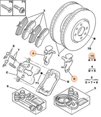

These are available from your dealer:
(10) Set of 2 Sound Deadening Pads Kit, part: 440717, £31.38 inc. VAT
These are bespoke parts, so probably won't get them elsewhere.
.... I'd be claiming the cost back from your 'mechanic'.

Do you mean number 70 in the picture? The screws that hold the disc when the wheel is off?

No, I'm assuming the disc pad damping units (10) that can cause rattling noises if missing on this vehicle.
