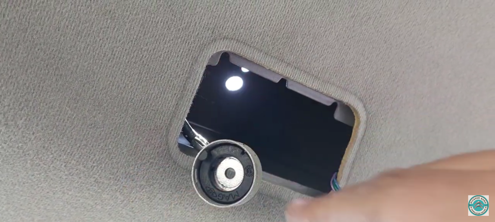

xantia_v6 wrote: 06 Jul 2024, 07:49 If you find that you have the amplifier can, you can bypass it and connect the antenna directly to the coax cable.
Hi,
I've got this little stubby metal cylinder at the base of the aerial. This pic is from a video but it's like mine. Mine has white corrosion on it. How does it work? Would a cleanup (contact cleaner etc.) help?
I can't see these online anywhere.
