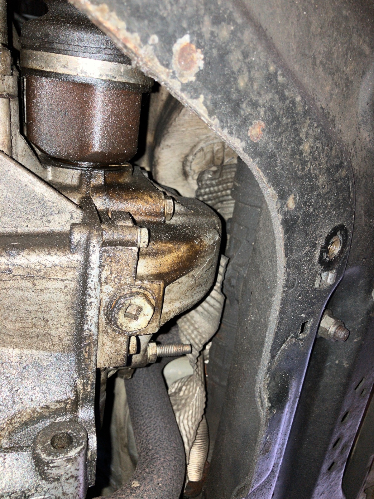

For now, I can’t even figure out exactly how to check and fill the gearbox oil (probably being a wuss!). Is the check level plug on the back of box, near where driveshaft enters it? Top bolt in this photo?
Do I fill it through this, or need to remove battery and cover to find a fill port on top?

Re: Noisy gearbox bearings
Sorry ignore me, I found a YouTube that shows it’s further outside nearer the wheel. I’ll give it a go.
The Citroen gear boxes often do not have a level plug, instead you drain the oil and then refill with the correct amount through something on top such as the vent.
