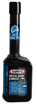

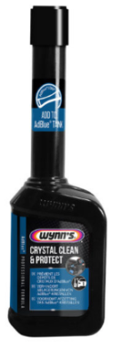

You really should be using an anti adblue crystallisation additive when you top the tank up. I suspect if you have left it a year that some of the urea has started formulating crystals in the supply line or at the injector itself. I would get some additive in immediately and allow it to work through the system in an attempt to breakdown any blockage. This has worked for others. Then make sure you add some each time you top-up and don't leave it so long before topping up next time. I top mine up about every 3 months or so. I buy the 10-15 litre containers, then add the Wynne's additive to the new container in the appropriate mix and then it's always there ready-mixed in the solution when I top mine up.
Leaving the tank to get too low means there is a lot of air in there and that of course can add to rusting of components and crystallisation.
I use this:
You'll find there are a few brands out there, but make sure you don't get the commercial version of this.
I use this:
