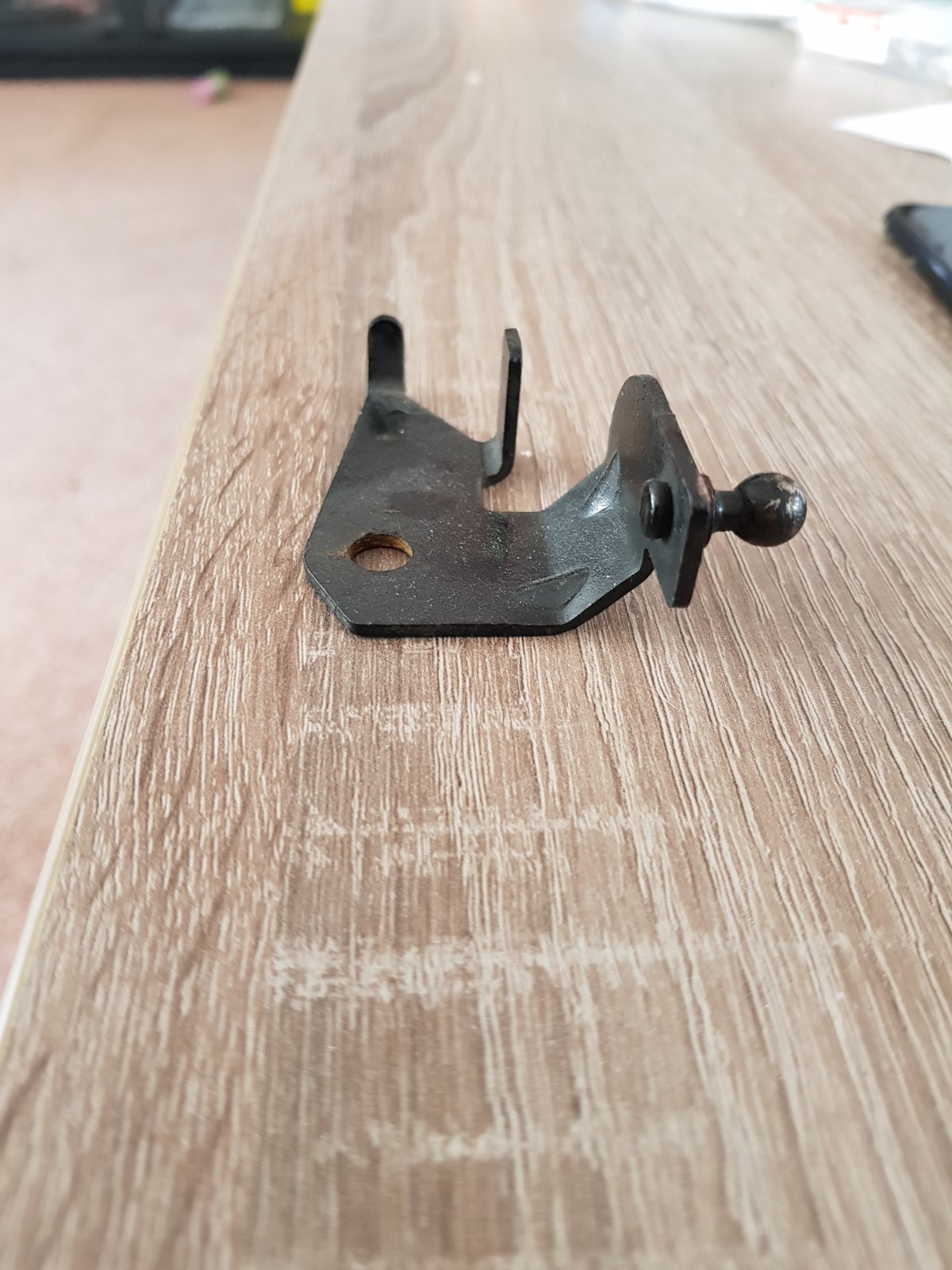

It's dependent, if you replace it with an original, or other brand.
In the past i replace them from an other brand, then also the car stands to high and it was not possible to adjust it with the diagbox.
I find out, that the part on the arm witch hold the arm of the high sensor was wrong.
Original there is an high different between the two plates.
I hope you understand what I mean. It's about the plates that are bolted on the lower arms and where the arms from the high sensors are connected to.

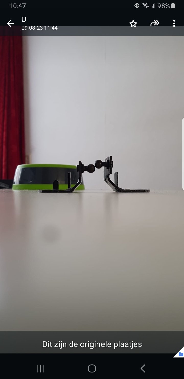

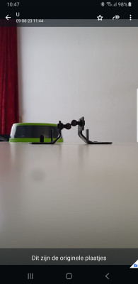

I mean this part, again they are not the same between left/right.

Here you can see, they are the original ones, that the bal head are not at the same height.
In my case when i had the problem, with the height of the car i find out, that the ones on the new lower arms had the same height between left/right.
So i replaced them with original ones.
Otherwise it's not possible to adjust the height with the diagbox, because there are to much difference in the data from the height sensors.

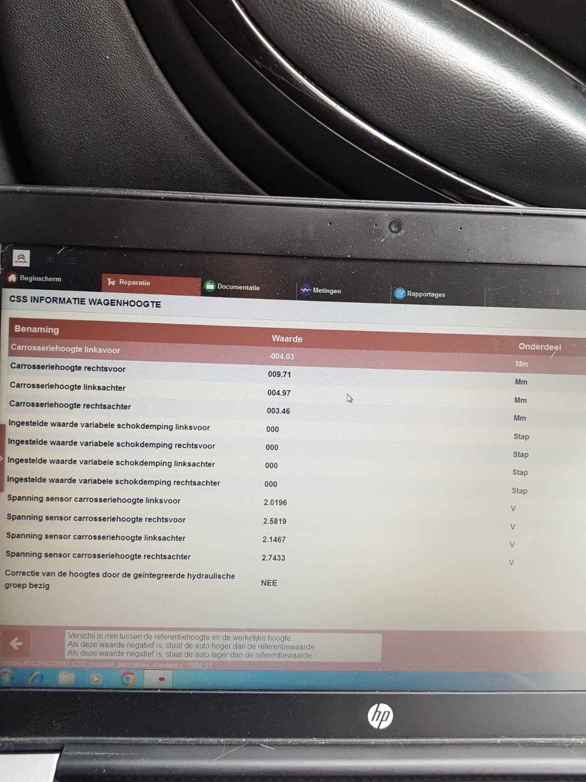

As it is more then a year ago, i don't know, but at my car it was the left bracket with was wrong compared with the original one.
But i find out with the diagbox how the value must be.
The diagbox show the height in mm, you must try to get the same value from the left and right height sensor, then you can adjust the height of the car by the diagbox.
Greetings,
Kees.

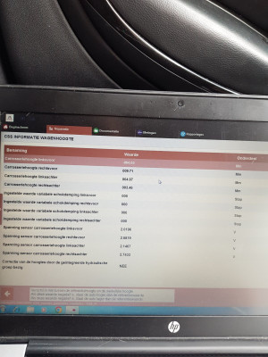

This is where you have to look.
