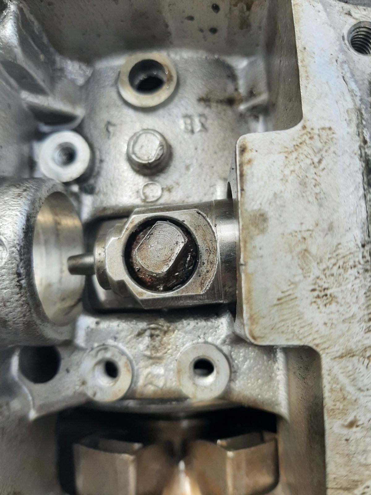

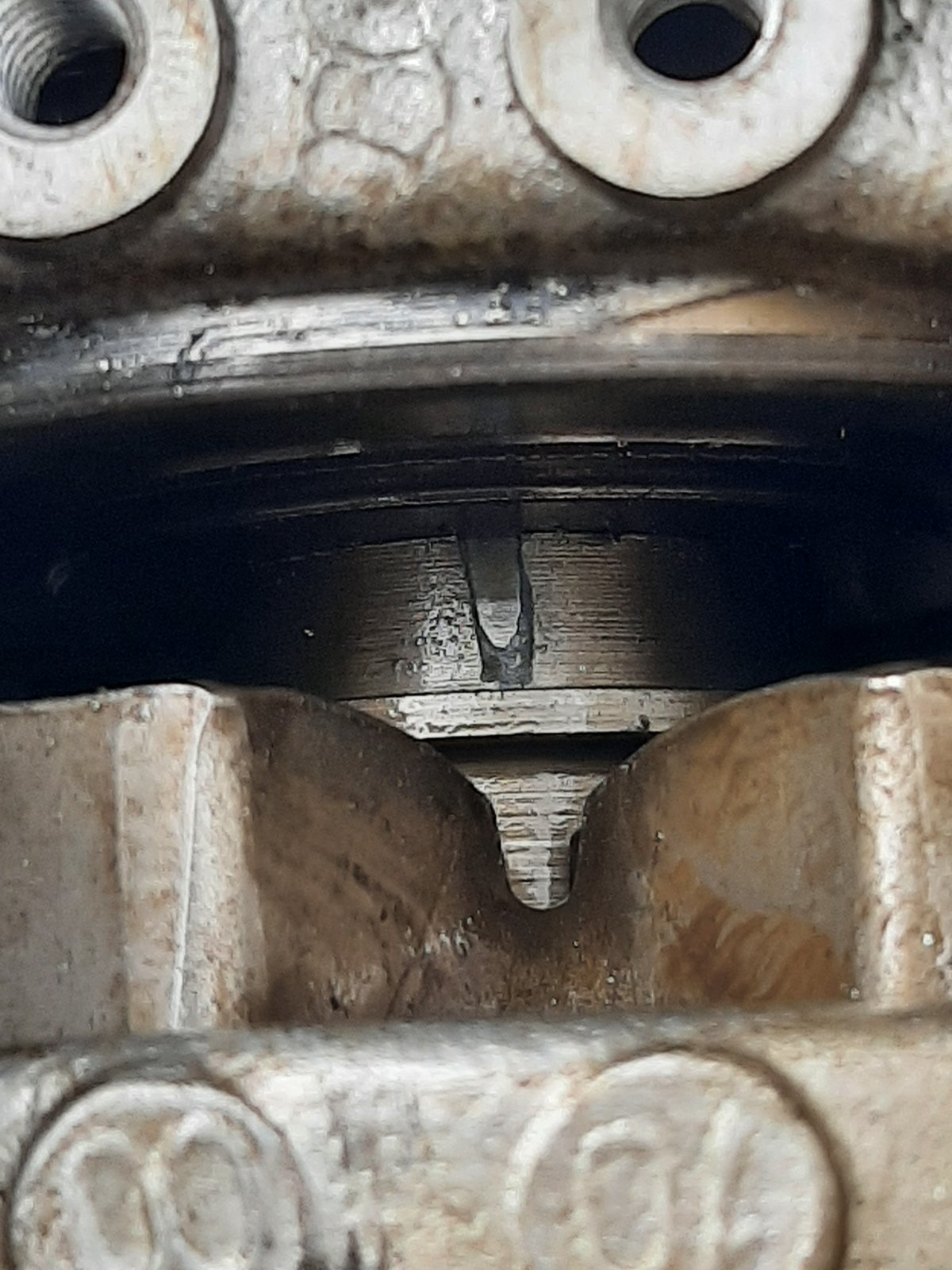

Stripping the pump and don't have a tool for this
Then looked down at the collar in front of the bearing to see this damage
Which is a damn, because have already bought the seals and the bearing.

Shut it off quickly.
Drained the sump over 2 hour period.
Unscrewed oil filter, not one drop came out of the old filter, it is basically dry.
In the hundreds of oil changes we have done, we have never encountered that, even on engines sat idle for years.
2 extra pieces of info.
We connected the wax-seal choke system to the pump. Cowboy had disconnected it.
Could it be washing the oil with diesel?
The sump has squeezed-out gasket maker all around it. Cowboy strikes again.
Therefore assume there is excess gasket sealant on the inside too - but why was engine OK 2 weeks ago.
New oil and filter and risk it
OR
Sump off and have a look ?
Also. Is it possible to change the oil pump with the engine in-situ ?

Ahh, if you have fitted a new timing belt kit it would appear you have somehow disconnected the drive to the oil pump. It's chain driven from a sprocket on the end of the crank and relies on friction between it and the cambelt sprocket and the crank pulley... There are also woodruff keys.
I very much suspect there is a problem in the crank pulley and cambelt sprocket area that's responsible, especially as it's been disturbed recently in replacing the belt. Recheck and ensure all the woodruff keys are present and both pump and belt sprocket are clamped tightly together when the crank pulley is in place and the crank bolt fully tightened.
