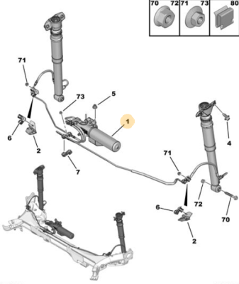

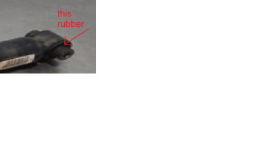

hello friend i need some help, i have my 3008 2.0 hdi i have noise from the rear left side there is a hydraulic line with them they are good no knocking noises but only i am hearing like a ring ring ring like a bell ringing on the left side

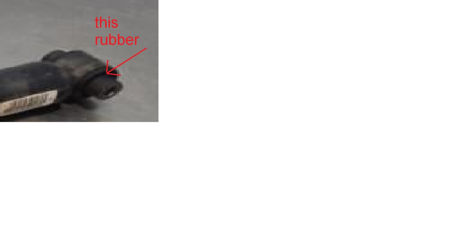

i started investigating i saw that the rubber its not good my question is can I change only the rubber It is not worth spending and buy the whole system which includes 2 shock absorbers and a hydraulic pump and cost around 1,000euro!! for just a rubber
Peugeot 3008 rear and strange shock absorber

It's not listed separately by PSA, but it might be available as an aftermarket spare, or a polybush.

RichardW wrote: 24 Jun 2024, 14:44 It's not listed separately by PSA, but it might be available as an aftermarket spare, or a polybush.
do you have any links by any chance or more help

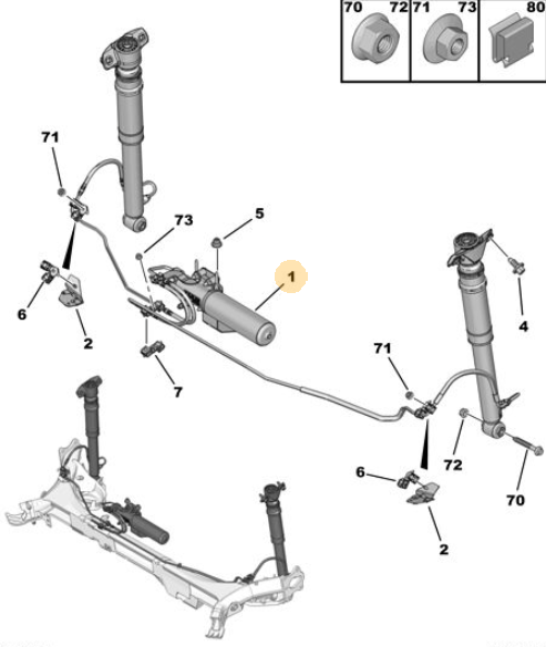

In fact it seems both the rear struts and damper control are a complete set, as the dampers are not even listed separately and the whole system has a significant price tag:
(1) Damper Coupling Mechanism, part: 527295, £1491.38
A set listed here new and a 10% code listed too:
https://www.ebay.co.uk/itm/394853471141

Do you not get an official failure sheet? It looks like the system is a mechanical self contained roll control system, and this thread: https://www.peugeotforums.com/threads/3 ... il.228865/ suggests failure is common, but the system can be easily removed and replaced with std shocks. Has not come up on here as far as I know!
