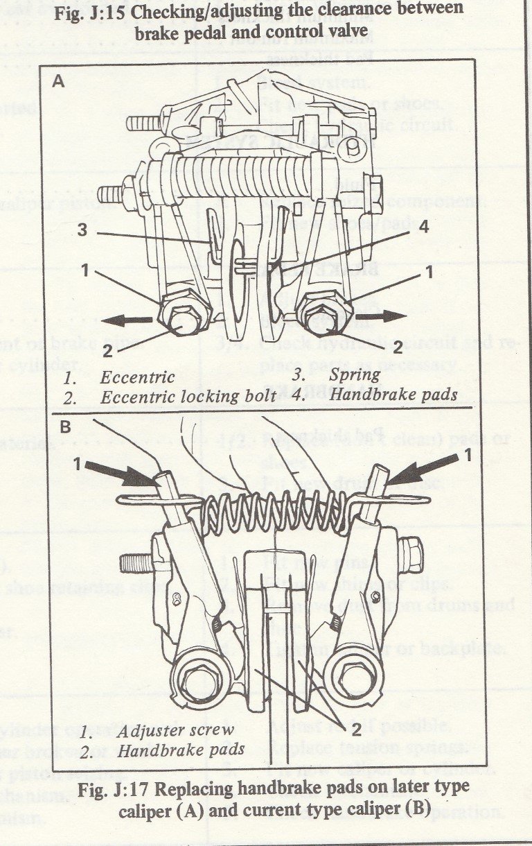

The cables themselves are able to be adjusted using the nut and locknut on the cable ends. By this means the pads can be made to move closer to the discs, but the main adjustment of handbrake pad to disc, is made using the eccentric nuts and their locking nuts at the pivot point. The spring (item No.3 in the image) actuating on the handbrake pads is an anti-rattle spring, and should not (from memory!) push the pad against the disc. Is it free to move and do what it is designed to do?
As myglaren states, getting the adjustment 'just right' is a real swine.
If you disconnect the cables, remove the top spring, then actuate the levers to push the pads against the disc by hand pressure, you should see the purpose of the eccentric adjusters at the pivot points. Slackening off the eccentrics locking nut will allow a clearer visual on the action. Once the action is understood and adjusted as required, then replace spring and cables to get the required amount of movement - and release - on the cable adjusters. It's a real pain.

The smaller spring (#3 in your image) isn't pressing the pads against the disk, but it is pressing them firmly down in their bores. I'm guessing this kept the pads from retracting fully when the brake was released. I tried flipping one of them over so it's not pressing as hard on the pads and they're free to move. This reduced the sound quite a bit and the brake still appears to work correctly.
