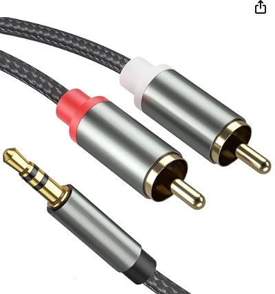

Hello. I recently purchased a Peugeot 607 2005 and i wonder if anyone knows how to use those rca connectors from the glovebox (White,Red,Yellow). I ve tried using a red-white RCA to 3.5mm audio jack but it does not work.
I tried searching for a way to activate those rca ports but i could not find anything in the menu.
Is there anything i can do to use them?Do i need a diagbox to activate them ?
I am currently using a FM Modulator but it does have lots of backround noise.

Those ports are only for connecting basic audio and video to something like an old camcorder or other device. You need to change the audio source in the Head Unit audio settings to get anything, but honestly there's really no point as you will have no control over anything except the volume.

So the only option i got its either FM modulator or change the head unit completly ?

I want to play music from my phone and some friends who had those rca connectors can listen to music from their phones, they just plugged in the RCA-to jack cable and selected AUX from source.
I dont want to burn CDs or listen to radio. And the car does not have an AUX plug, or bluetooth. Only those RCA ports, and i tought that i can somehow use those ports to plug in an AUX cable .

The system is over 20 years old now, so you have to expect limitations.
You'll probably need a small audio jack to RCA converter to use this using, the Left / Right RCA sockets only and select the audio source once you have a physical connection to a device.
The only other thing is like what you have already - a bluetooth / MP3 transmitter over FM in the 12V socket.
