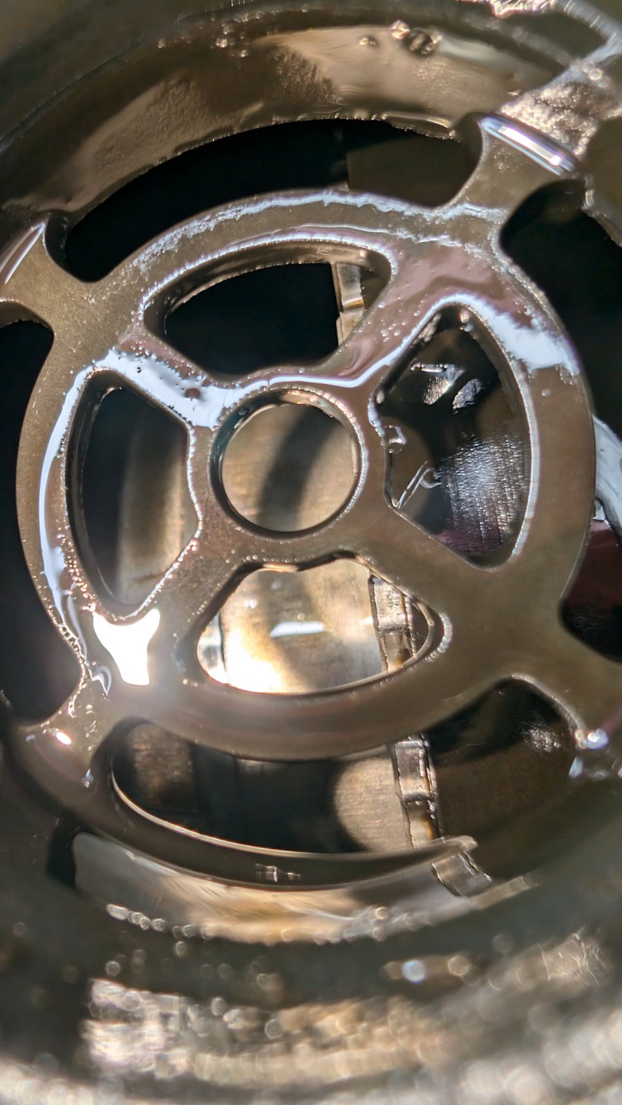

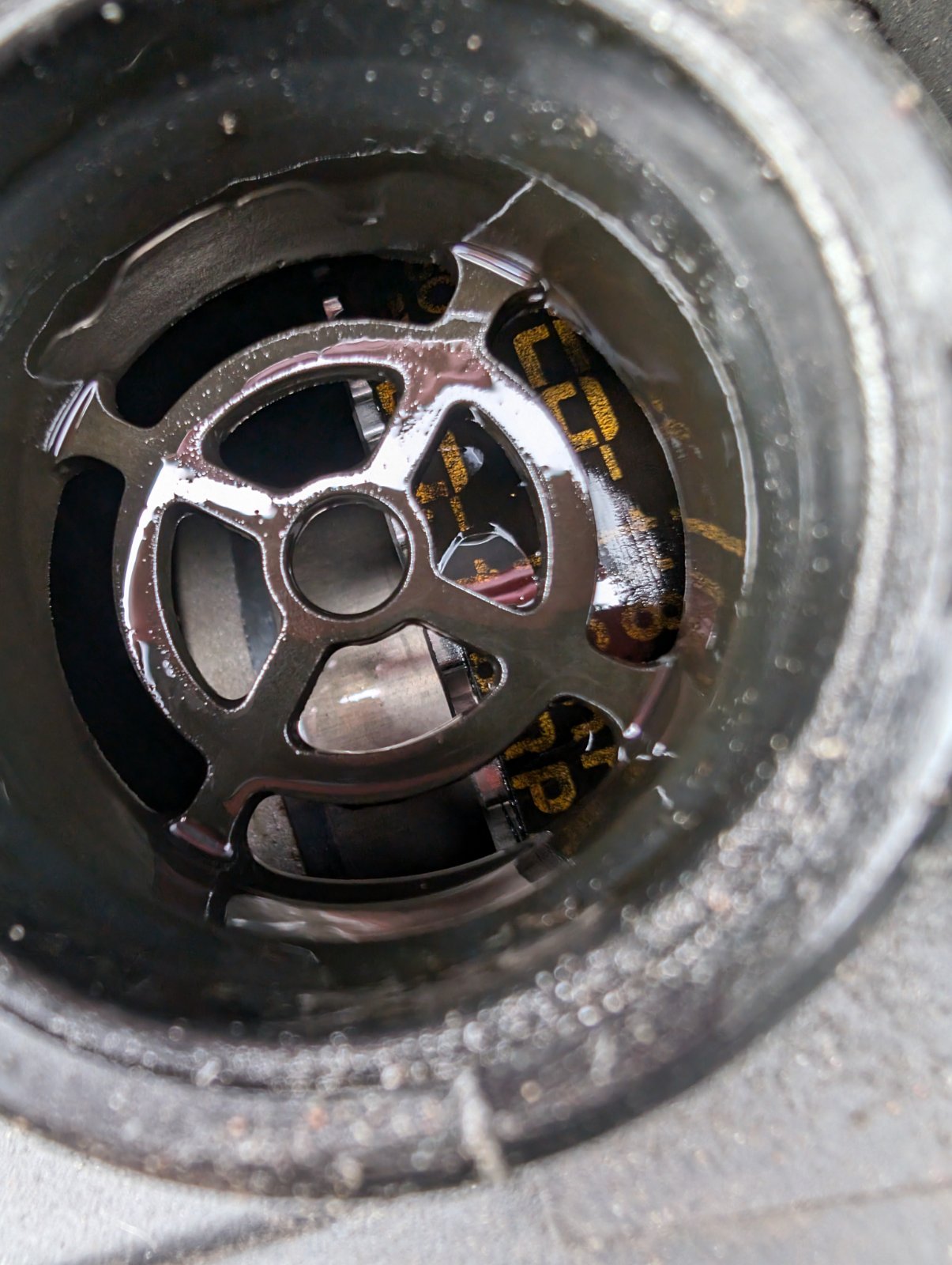

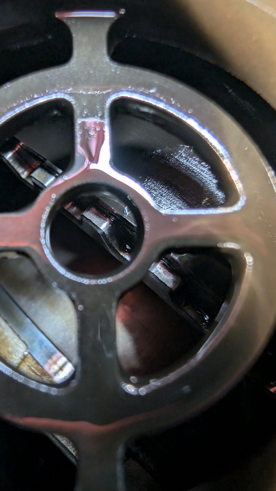

I know its not an exact science, however, does this look like the original or a replaced belt?
2017 38k VF7**************[VIN obfuscated, can be read by forum staff]
- x 6950
Re: C3 Timing Belt gurus's
Nobody can tell you that from just looking at it.
On your vehicle it MUST be replaced at 6 years (now overdue if not been done) or 64k miles for the first change to have a newly designed belt fitted, then it is every 128k miles or 12 years.

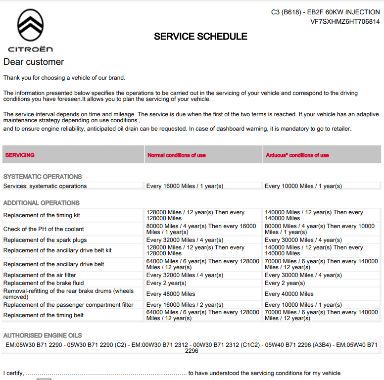

They are plain incorrect. That is only applicable when the first belt change has been done! So unless they are assuming it has been done already, or can provide you with evidence or confirmation that the first belt change has already been completed by Citroen, then that is incorrect.garpat32 wrote: 22 Jun 2024, 16:09 Response from one of the local Citroen dealers
"I have checked the service interval for the timing kit and its every 12 years or 128000 miles. I would advise allowing the vehicle to meet one of these
Requirements before changing unless there is an issue which would require you to change beforehand"
If you require the evidence then here it is with your VIN clearly shown top right. I have highlighted the relevant part and as you can see, first change is shown and subsequent change at 128k miles after that.
This is from the the same live database they use

Yeh mate, but thanks for confirming. I'd already read on here ref the change at 6 years etc so I was a bit surprised with the response.
- x 6950
He's only right if it's already been done once, so I'm assuming you told him all that and wanted to check if there is any service evidence of a dealer-replaced belt to date. If not, then it's either the original and needs doing on a time basis, and needs to have the correct revised replacement belt fitted to give you the peace of mind for the next 128k miles (although I'd probably get it replaced way before that personally speaking), or it's been done outside the dealer network.
