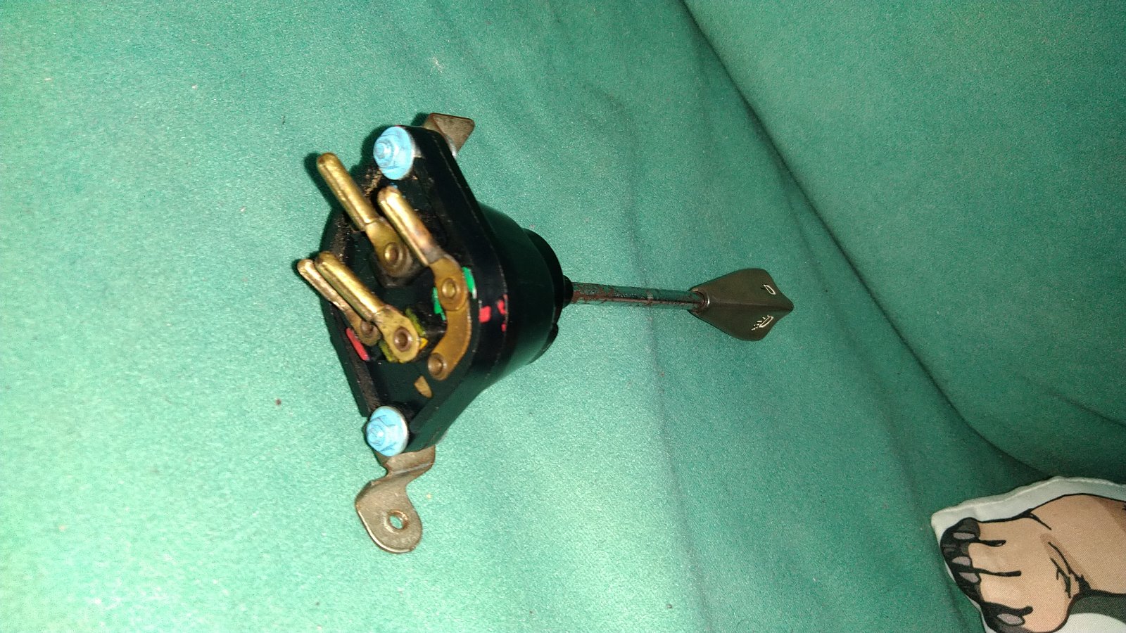

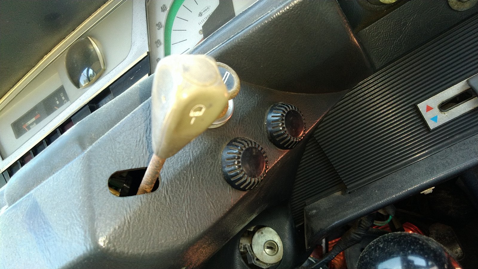

Hello, trying to remove the headlight switch from my 1973 GS but boths sides of the switch is bigger than the hole on column.

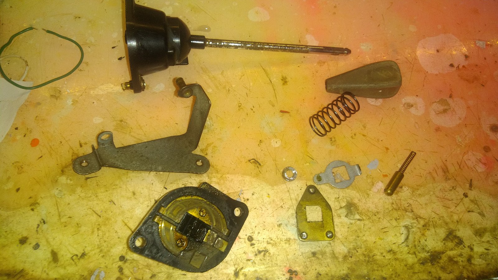

I pulled out the plastic piece, it was stuck but popped out. Drilled the rivets and cleaned the contacts inside, now switch works perfectly. I wonder why dipped beam works in both first and second position. CX light switch also works like this. Must be a Citroën design
