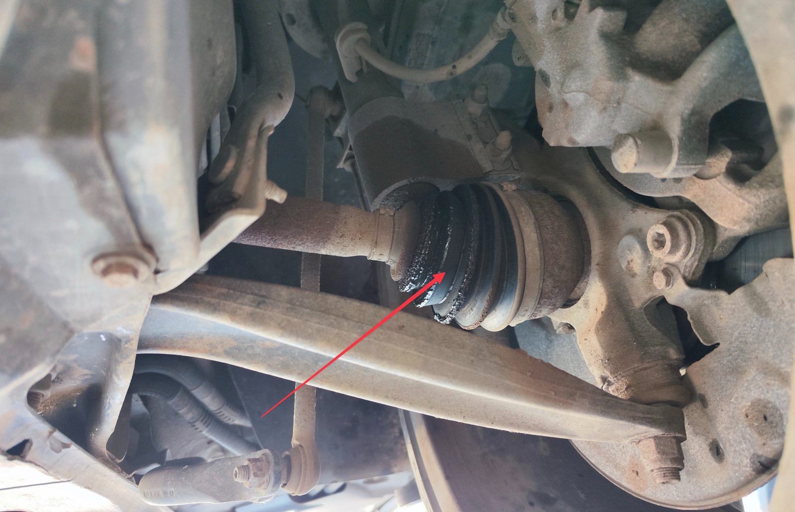

Here is the first one, from the transmission to the wheel:

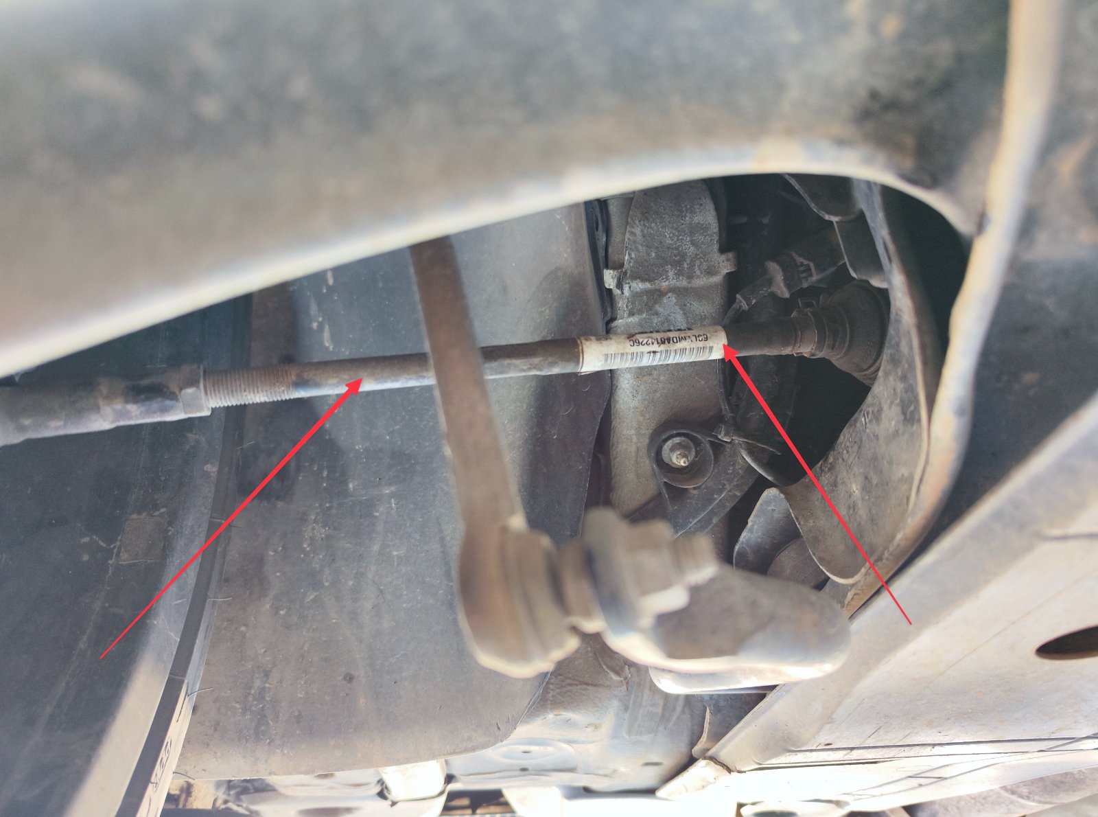

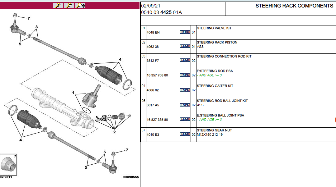

Direction rod (it has a slight play which has amplified noise on bad road conditions):

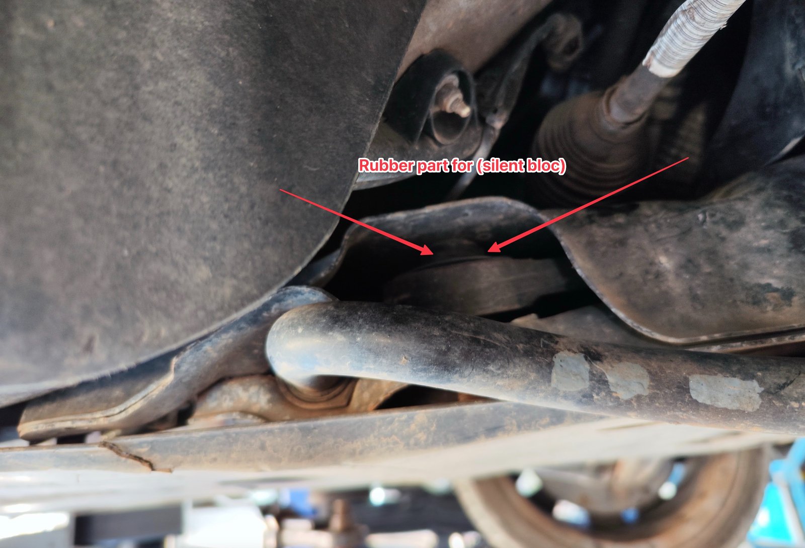

Silent bloc in the piviting arm (it is starting to show signs of wear). I think there is another part in the other side, I would also like the part number of the rubber bushing.

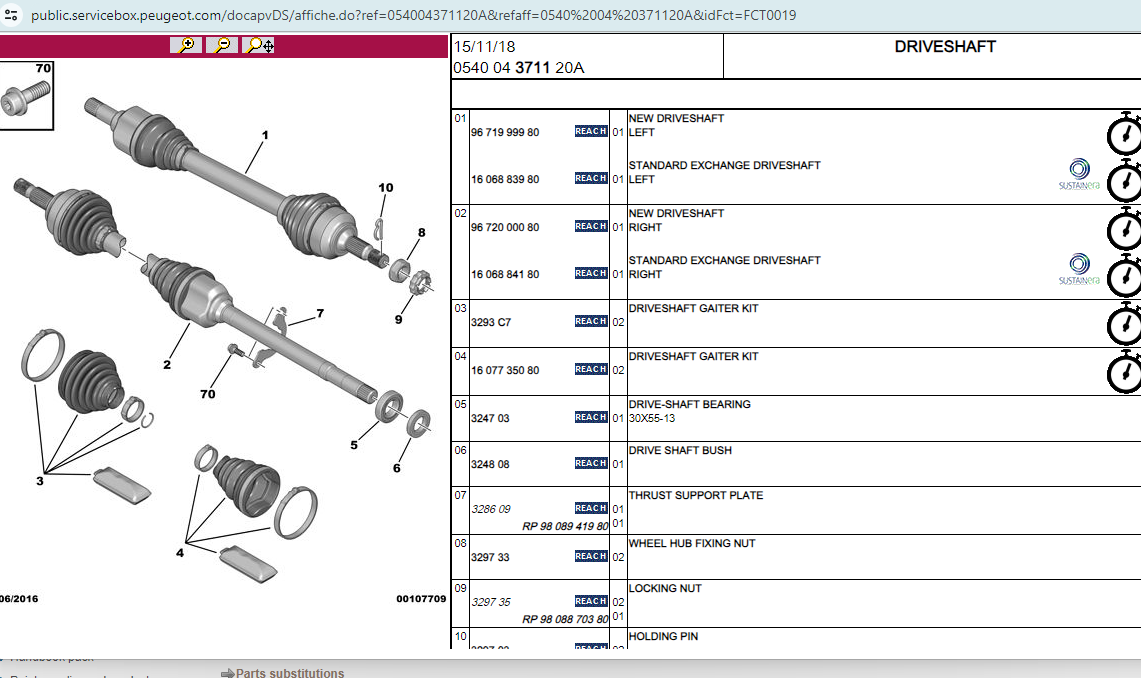

That is the drive shaft outer CV joint Gaiter:
Item 3 - part no 3293C7 at £56.33 In the UK. These should be easily available from other sources and are usually easier to fit!
eliezedeck wrote: 19 Jun 2024, 06:56
it's usually the track rod end that wears first (item 5), but they can develop play in the inner joints (3) - these are more difficult to change!
Track rod end 3817A5 (£118.78) or cheaper 1682733580 (£35.92)
Track arm 3812F7 ( £114.54 ) or cheaper 1635770880 (£42.41)

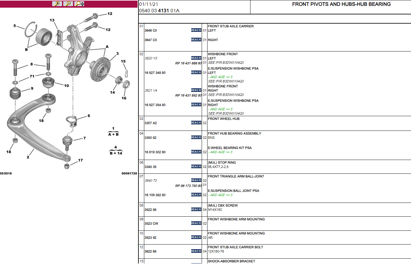

eliezedeck wrote: 19 Jun 2024, 06:56 Silent bloc in the piviting arm (it is starting to show signs of wear). I think there is another part in the other side, I would also like the part number of the rubber bushing.
Rear bush (10) - 352392 (£15.31)
Front bush (9) - 3523CW (£18.91)
Garages will often just replace the whole arm, as the bushes are difficult to get out and the extra labour is not justified (but the Citroen price is nearly £500, so maybe not here!). For bad roads I would avoid cheap aftermarket parts however!

Quite often when you get these apart you find play in the bottom ball joint (7) - 9817375080 (£45.91) or Cheaper 1610938280 (£26.41)
