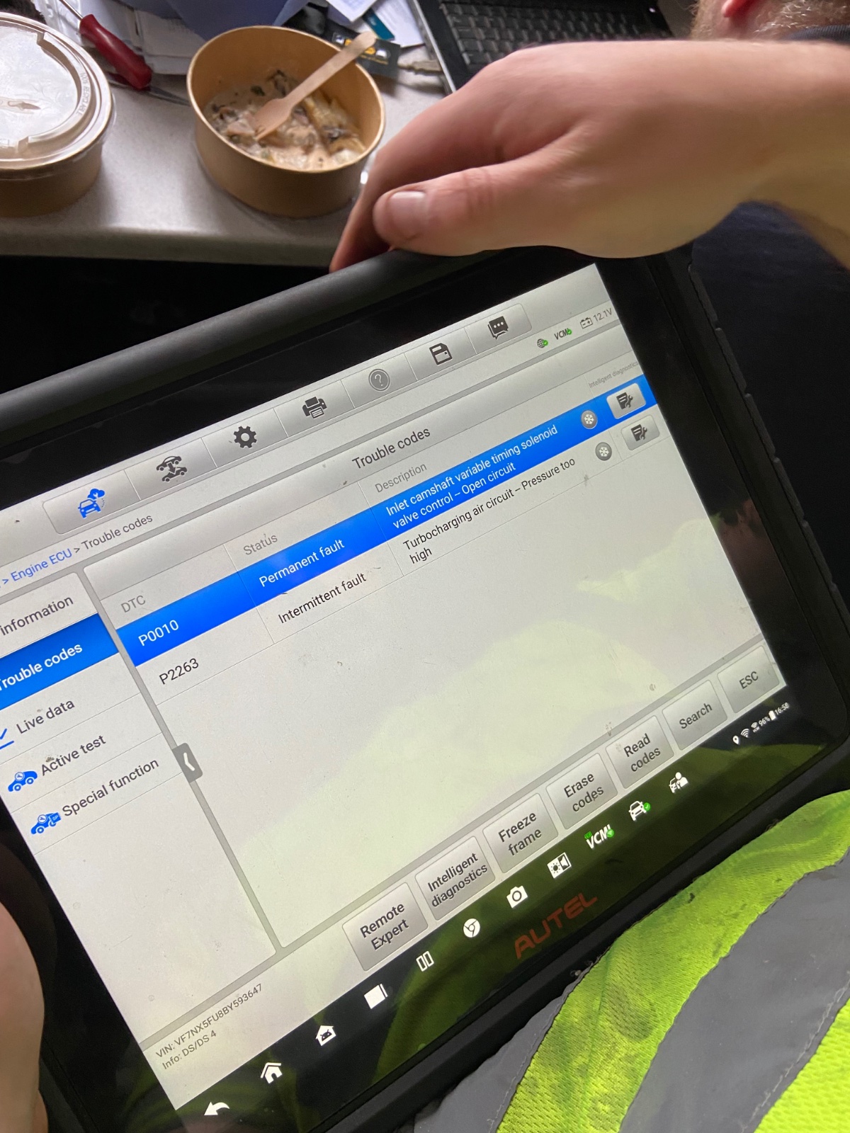

Another problem engine management light won’t go out after sorting abs anybody any ideas

Re: Vv seliniod
Here are the fault details:
Fault Code: P2263
Description of Fault: Turbocharging air circuit: Pressure too high. Check the boost pressure: Reduction in the turbocharging.
Conditions of activation of the diagnostics:
Engine management ECU in main triggering phase.
Conditions for Fault to clear:
  • 50 consecutive cycles without any errors
Downgrade Modes whilst Fault is active: -
Symptoms:
  • Unstable idling
  • Idle speed too high
  • Lack of power
  • Engine speed stuck
Suspect Areas:
  • Turbocharging pressure sensor
Fault Code: P0010
Description of Fault: Control of the inlet camshaft dephaser solenoid valve: Open circuit.
Description of the diagnostics: Open circuit on the power stage of the inlet camshaft dephaser electrovalve.
The following conditions have to be met:
- Engine management ECU in main triggering phase
- Battery voltage between 9 and 18 V
- Engine speed above or equal to 40 rpm
- Fuel gauge module supplied for 2 s
  • No fault codes found: P0010, P2088, P2089 (For 1 second)
  • Change to butterfly mode
  • Camshaft in rest position
  • Torque limitation
  • Advance in rest position
  • Deactivation of the turbo
  • Deactivation of the vehicle cruise control and speed limiter
  • Switching on of the warning lamp and/or warning message: Warning lamp MIL
Symptoms:
  • Starting impossible
  • Starting difficult
  • Stalling on starting
  • Unstable idling
  • Stalling at idle
  • Lack of power
  • Engine hesitation
  • Emissions outside the norms
  • Excessive fuel consumption
Suspect Areas:
  • Engine ECU
  • Electrical harness
  • Fuse
  • Inlet electrovalve

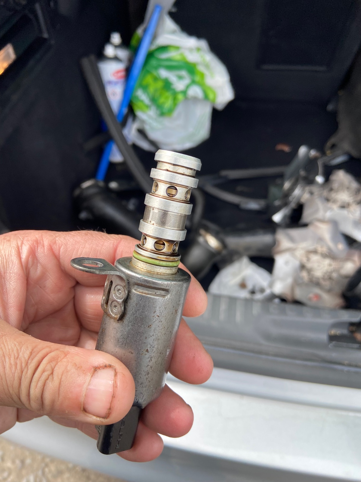

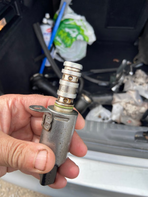

As you can see the problem with these valves over time they loose there filter screens
Missing screens
Missing screens
