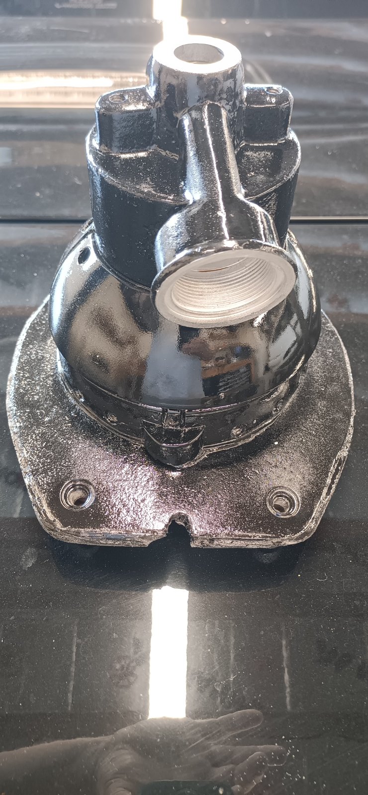

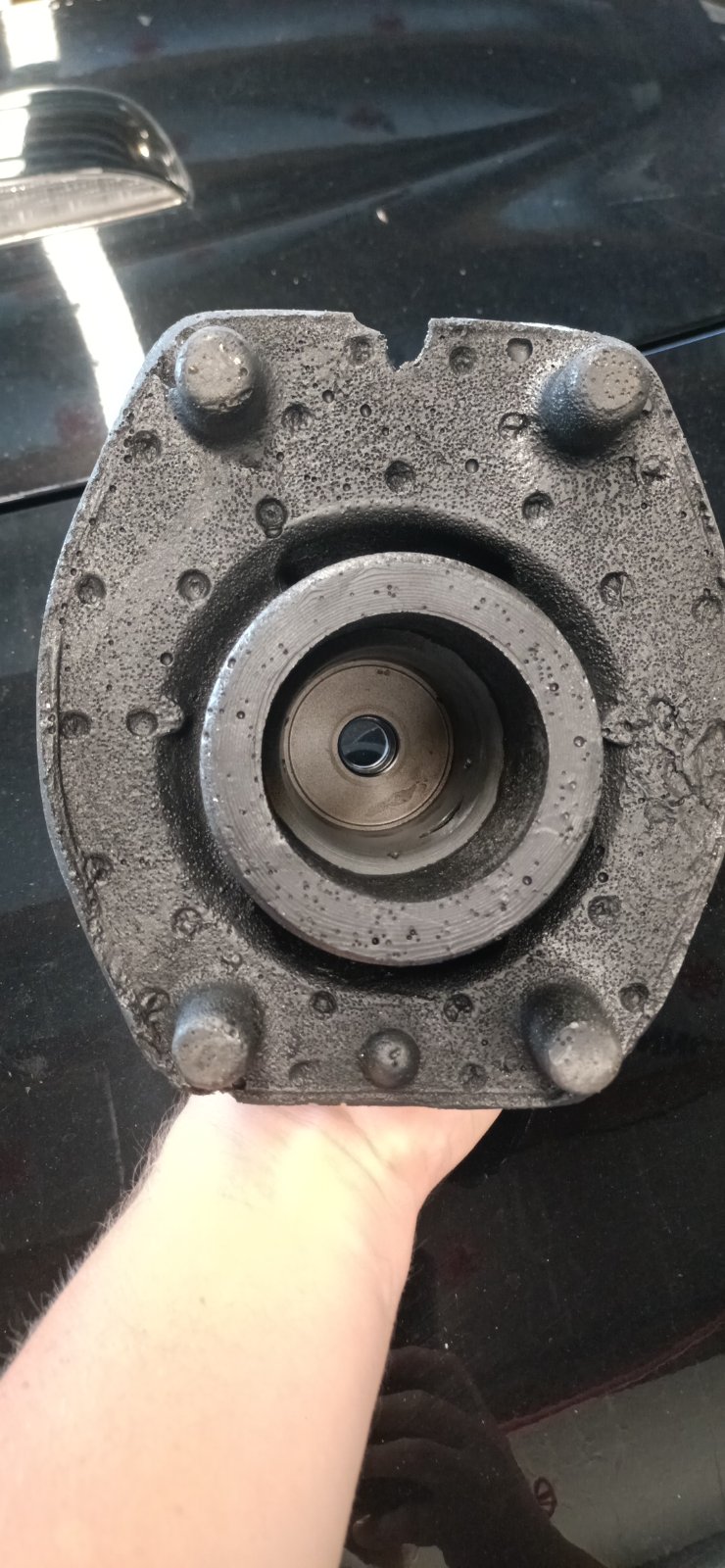

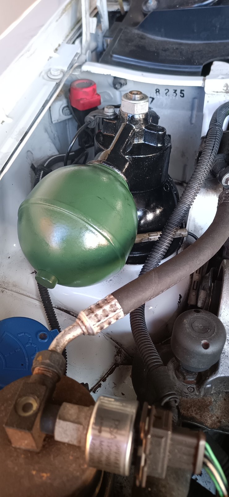

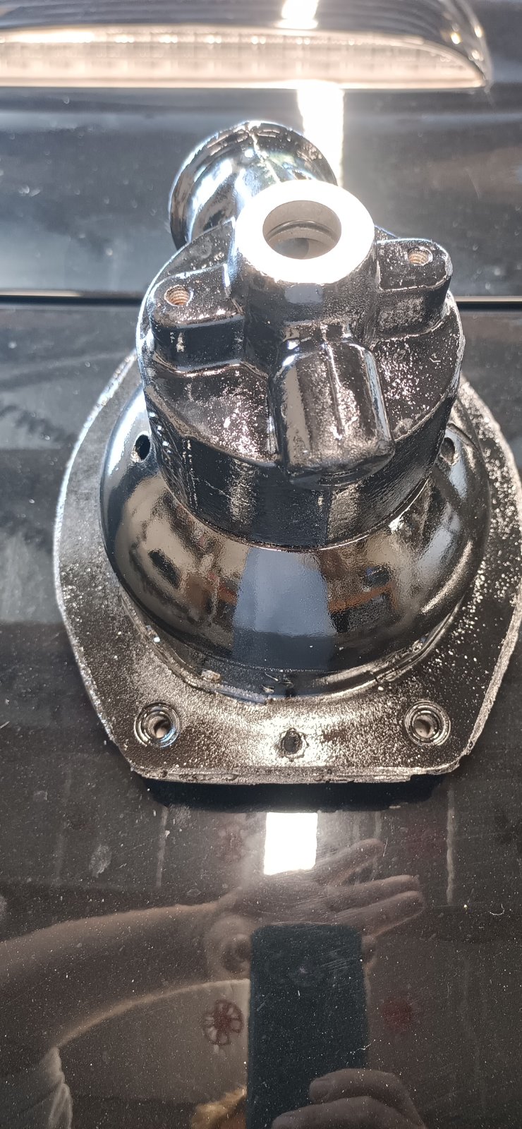

So after sussing out the engine and determining there wasn't anything actually wrong with it (clutch was rattling it wasn't a damn rod knock) the shock mount failed and shot the sphere up and into the hood.
Is there a reinforced, better quality mount available anywhere?
Anything I should know when replacing it?
Thanks
Shock mount collapsed

Oh dear... Those - known in these parts as strut tops - are no longer available new and hard to find second-hand in good condition.
There is/was however, a company in Eastern Europe who can rebuild your failed one... Used to be called something like KingAS or ElastomerEU and were/are, I believe, in somewhere like Lithuania... They were still a going concern a year or so back and hopefully still are.
I have used them in the distant past to rebuild XM strut tops, as have many others, with great satisfaction.
They could also rebuild other metal/rubber items like dual-mass crankshaft pulleys and engine mount bushes...

Sorry to see this has happened, I notice that this appears to be an XM without the Hydractive set up (small diameter hydraulic pipe connection seen) - that's quite rare I think and you might also need to ensure the replacement strut tops are the right type.
