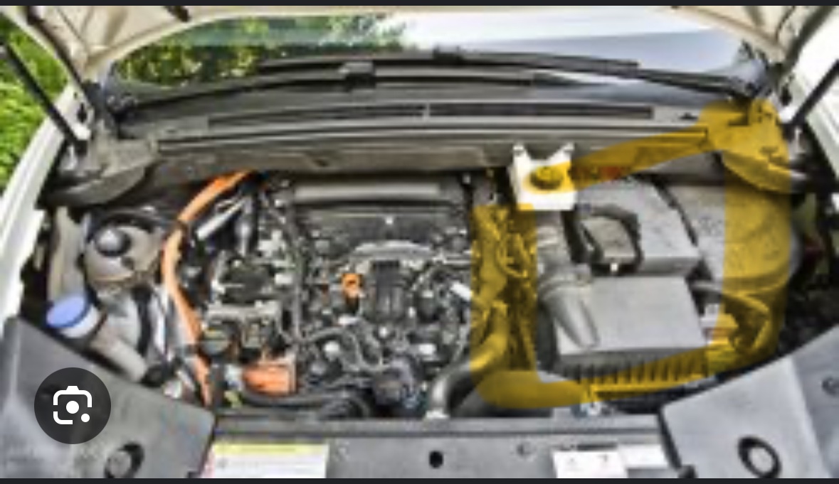

Hi all, throwing up an EML on this after a flat battery and replacement. I’m hoping that the mechanic unplugged something to get the battery in easier or am I barking up the wrong tree?

Vin on this one?
Assuming DW10CTED4 and non-hybrid:
Fault Code: P0113
Description of Fault: Air temperature sensor at the flowmeter : Short circuit to positive or open circuit: Temperature too low. Voltage higher than 4,6 V for 1 seconds.
Conditions for Fault to clear:
  • Driving with the engine hot for 5 minutes
Downgrade Modes whilst Fault is active:
  • Reversible deactivation of the vehicle speed limiter
  • Reversible deactivation of the vehicle cruise control
  • Cutting of the exhaust heat saver function
  • Switching on of the warning lamp and/or warning message: Warning lamp MIL
Symptoms:
  • Diesel fuel consumption a bit higher
  • Smoke from the exhaust
Suspect Areas:
  • Electrical harness
  • Connector
  • Air temperature sensor at the flowmeter

Will get my VIN on my way home from work!
I’ve tried to highlight the part the mechanic removed hoping it might be involved!
Also cruise control is deactivated- no smoke and fuel consumption seems normal.
x 6950
Re: P0113 ds5 2012 2.0
Cruise deactivation is listed above in the downgrade modes whilst this fault is active, so that's why.

Sounds like the MAF is not plugged in properly - it's just behind the air box.

Yep! Sorry for the late update! Didn’t realise it had been undone when the battery was removed. Quick question what are the red light yellow light parameters for low fuel?
