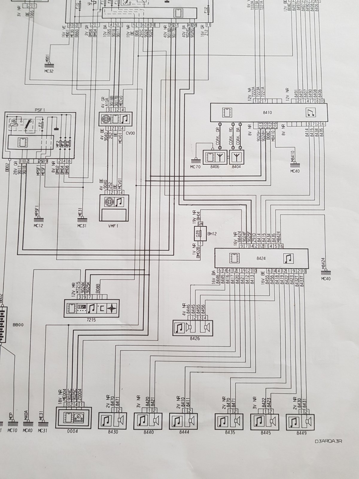

Re: Citroen C5 X7 HIFI audio only two front speakers working
Here you see the connections from the RT4 and amplifier.
If this is not programmed correctly by the diagbox, then you will not hear the sound from all of the speakers.
There is only one choice on this vehicle with the Amplifier - fitted or not fitted. With a factory-fitted amplifier, I would not expect any reason to change anything in the BSI, since the amp has not been removed. However, this doesn't mean somebody has been into the BSI configuration and changed some settings to deactivate the amplifier, in which case this would also cause a problem.
But also be aware that the amplifier has CAN connections to the BSI, the Display Screen and the RT4 so an aftermarket android unit may still not work if it is not compatible.
This is the relevant diagram for both the Audio:
With the exception of the wiring codes, most of the component codes are indexed here:
PSA Electrical Diagrams - Wiring & Symbols Codes Index
