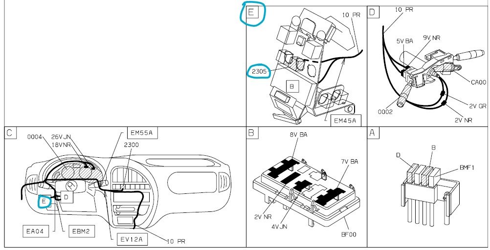

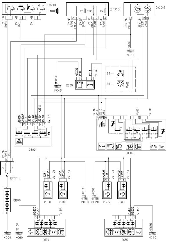

Its a fairly simple circuit the relay is located as shown below. Its a 3 pin relay plugged into a grey base (component number 2305).

Thank you very much wheeler for the diagram
