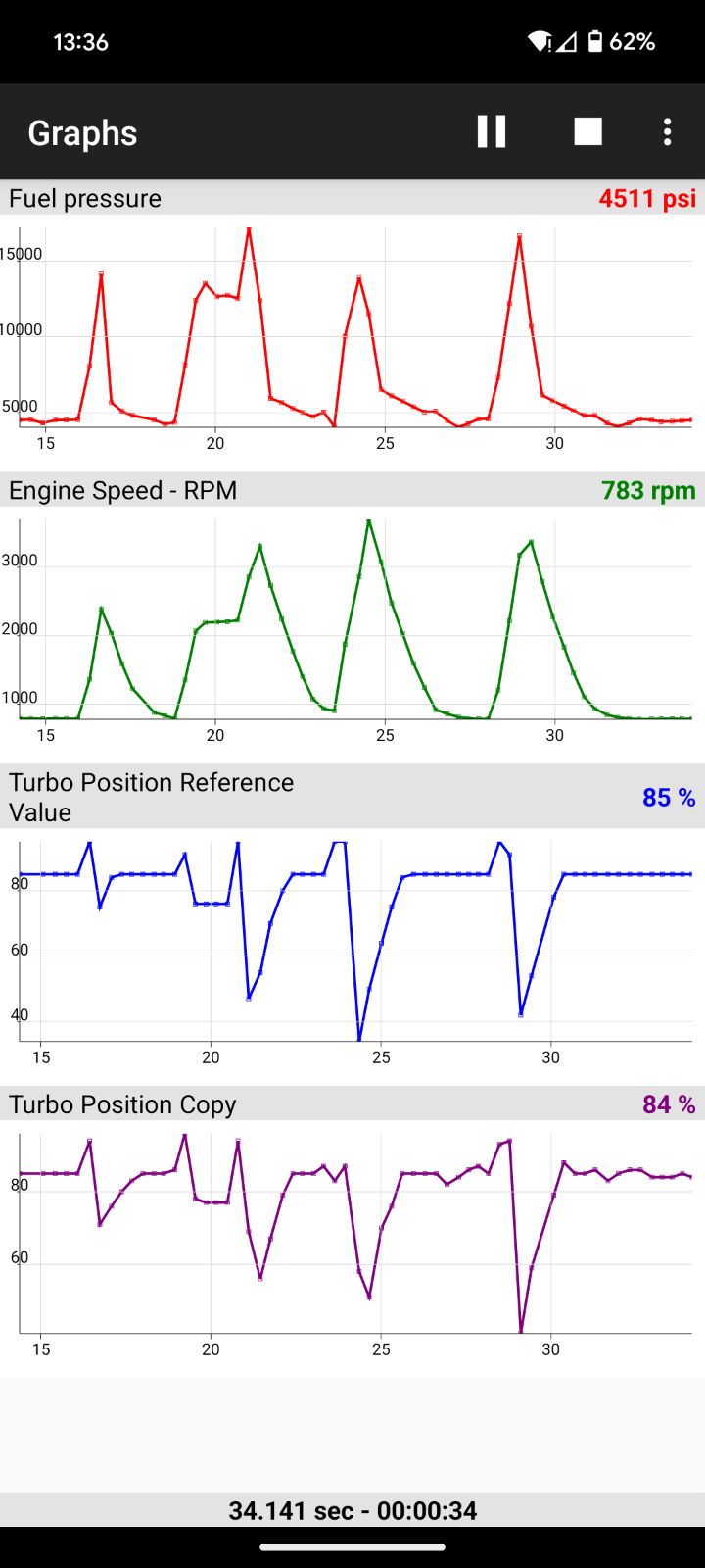

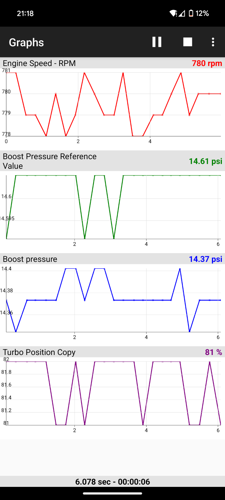

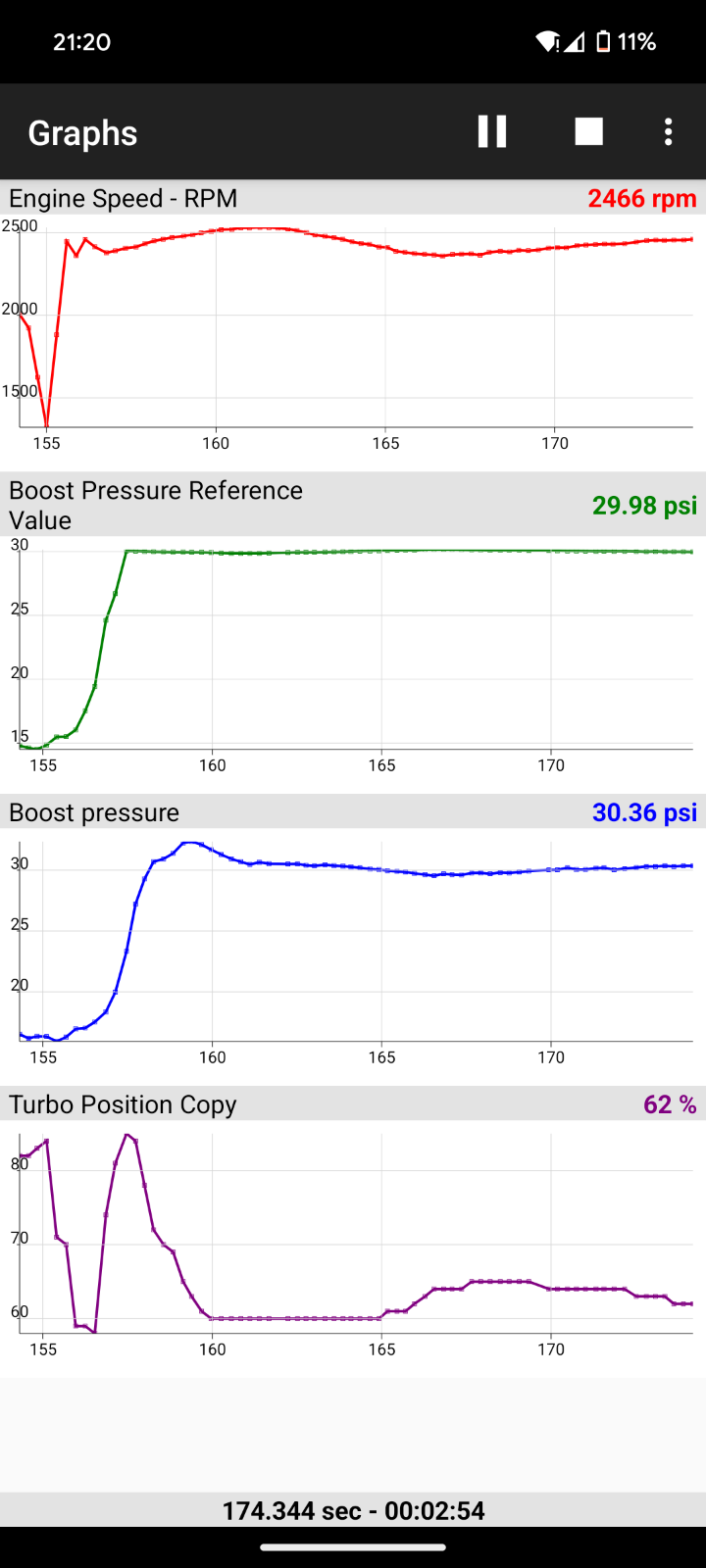

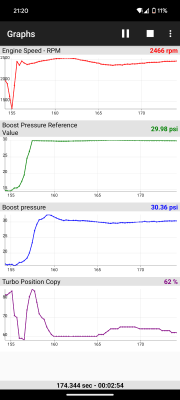

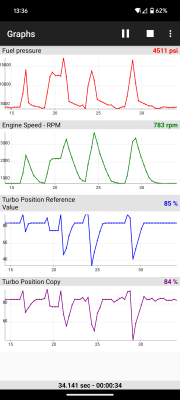

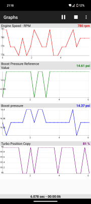

I've attached some screenshots of a recent live diag, unsure if this sheds much light, but any pointers would be greatly appreciated!!
IDLE scan
Moving scan

Maybe some more information before anyone replies.
Moving the actuator by hand with the ignition on, it goes the full range, from 0 to 100%, so I believe the position sensor is reading as it should.

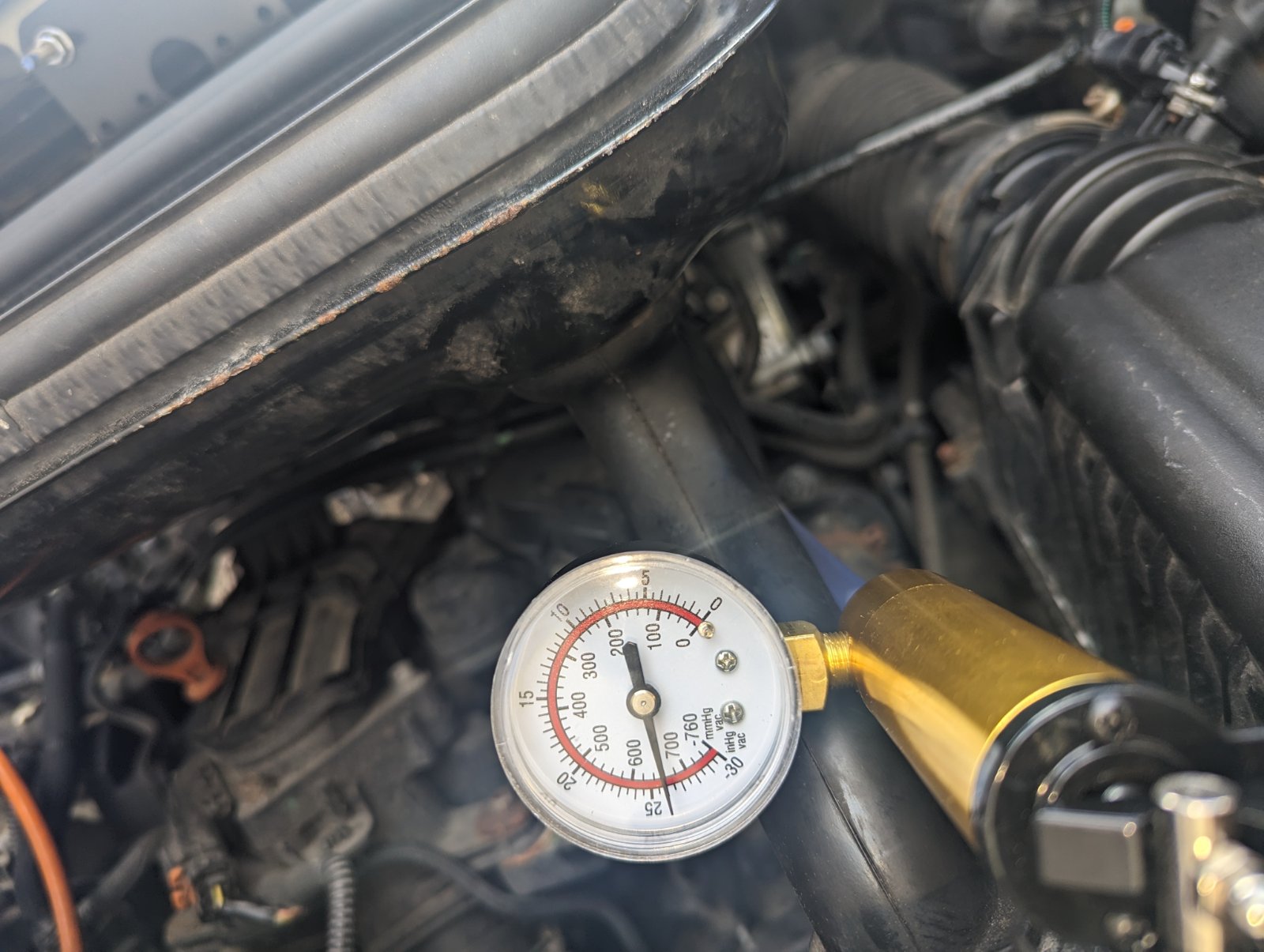

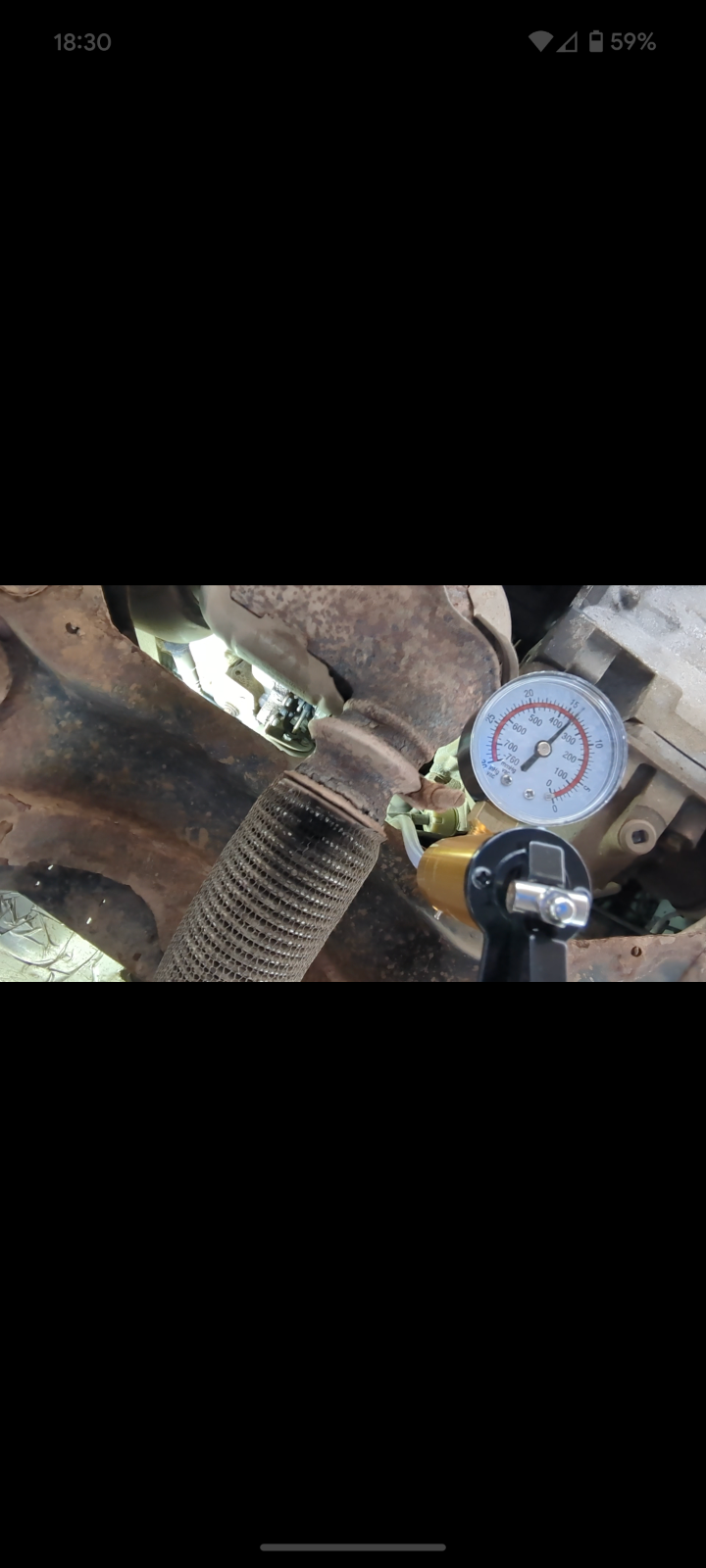

The value of the reading never drops below 60% when driving, even under load up a hill. The actuator is getting -15inmg at idle, and when revving under load it goes to -10inmg, I'll see if I can attach the video - unsure if this adds any value.
The vacuum pump (RHS of engine is making around -25inmg at idle. Few screen shots below for added information. Hoping someone can shed some light.
Cheers
Cheers
