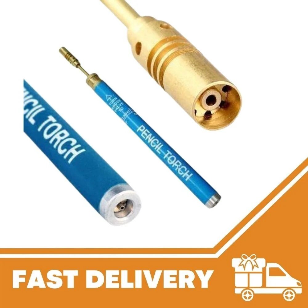

Heat, use a "Micro torch"....I have found them very useful/effective. Note, get a very small butane "Pen type", the larger "Chief type" I think are a little to big to get into tight spaces and the flame a little to large. These allow you to keep the flame directly on the union without over heating the pipe, I always replace seals but they never seem to suffer as they are deep inside the fitting.

I have one of those pen torches. Cheaper than chips at £2.50 from the far East, the only issue I found was the very small amount of gas they can hold, resulting in frequent refills. But does the job.

Heat, but less of it ....to soften the seal if it has gone hard....again the Micro Flame allows you to control where and how much and allows you to build up the heat slowly.
