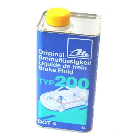

Been looking for alternatives and i found something called Dot 4 Low Viscosity and also Dot4 Class 6 (unsure if it's the same thing) , that is supposed to be used on cars with ABS and ESP.
Could C5 (X7) benefit from it? Or a ATE TYP 200 would be a better choice?

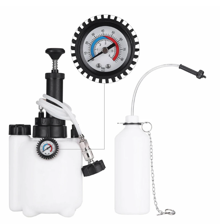

Got myself one of those pumps to change brake fluid with pressure and i think that will be ok for both C5 and Xantia (Something like this: https://pt.aliexpress.com/item/1005006444069240.html)
Anyone have experience around here with these things? Would like to change the fluid as soon as i could have time for do it.

Never used anything other than normal Dot4 fluid at work or else.
Unless it especially calls for LV brake fluid i wouldn't bother. Service box just says "dot4" C5x7.
But i've only been working with Citroën and Kia, maby it is a VAG/Mercedes/Bmw thing?
The Germans like to "do their own thing", not just the French XD

I think i will go with the ATE TYP 200 then. It seems to be just a better DOT 4 with higher boiling points. :-D
Any advice on using the tool other than not putting too much pressure on it?
Need to find the details on how to bleed the clutch. The mechanism to do it seems bit distinct from the brakes...

Those brake blöeeders work, but i'm not sure i'd use it on the xantia clutch. Maby with just 1 bar.
I usually use the air-powered vacuum bleeders, on my friends Xantia HDI 110 i did a few partial changes by emptying the reservoir an filling with new fluid every time he came by.

I have been using a Mityvac pump for many years to bleed brakes and clutches which sucks the fluid out of the bleed screws. https://www.amazon.co.uk/Mityvac-MITMV8 ... B000FUMWTM It can be slow and air can be sucked around the screw threads. The container is too small though so I made another one from an air tight food container with a screw on lid and 2 bleed screws fastened to the top with one pipe to the pump and the other to go on the brake bleed screw. I marked it up at 50 ml levels so I can see how much fluid is bled out.
I also have a Gunsons pressure bleeder but do not like using it since it puts pressure on the reservoir and if the bleeder is filled with fluid can spray out if the cap does not seal.
