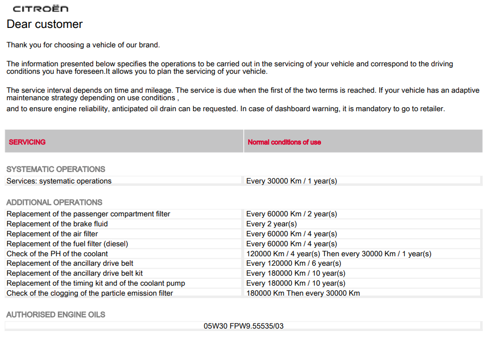

Good morning all
Is it possible to get a copy of the service schedule and a list of any recalls etc that need doing,
Thanx

Here's the servicing Schedule Steve.
Citroen do not list after-market campaigns. These are only flagged up as they are released and closed off when completed. There are none showing as due.
Here is the servicing schedule and the specific oil required:
Click to Zoom Also be aware that as you have the 1.5 Blue HDI, there are potential issues with the cam chain. Your vehicle has the 7mm one fitted and these can fail. Citroen are aware of it and are upgrading these to 8mm versions with all the replacement associated parts concerned - BUT only when there is evidence of failure, indicated by noise or a knocking noise in the timing side area.
Your vehicle falls into the build date range of the issue, so just make sure you use the correct oil and ensure the servicing schedule and checks are evidenced if not having it dealer serviced, otherwise Citroen may decline any extended goodwill if the chain fails on you.

Excellent, thanx for all that info Marc
