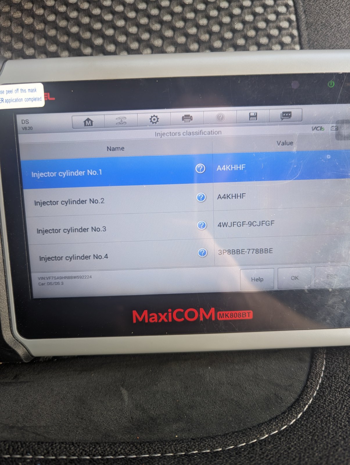

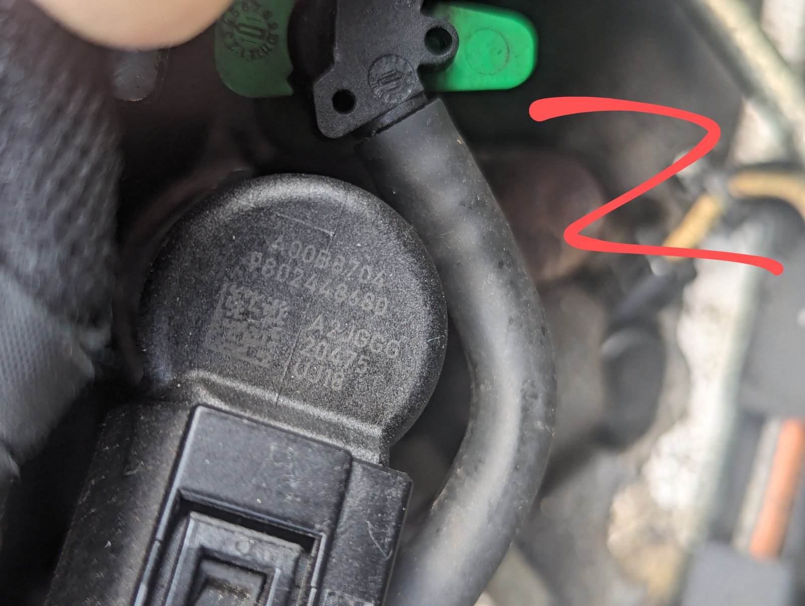

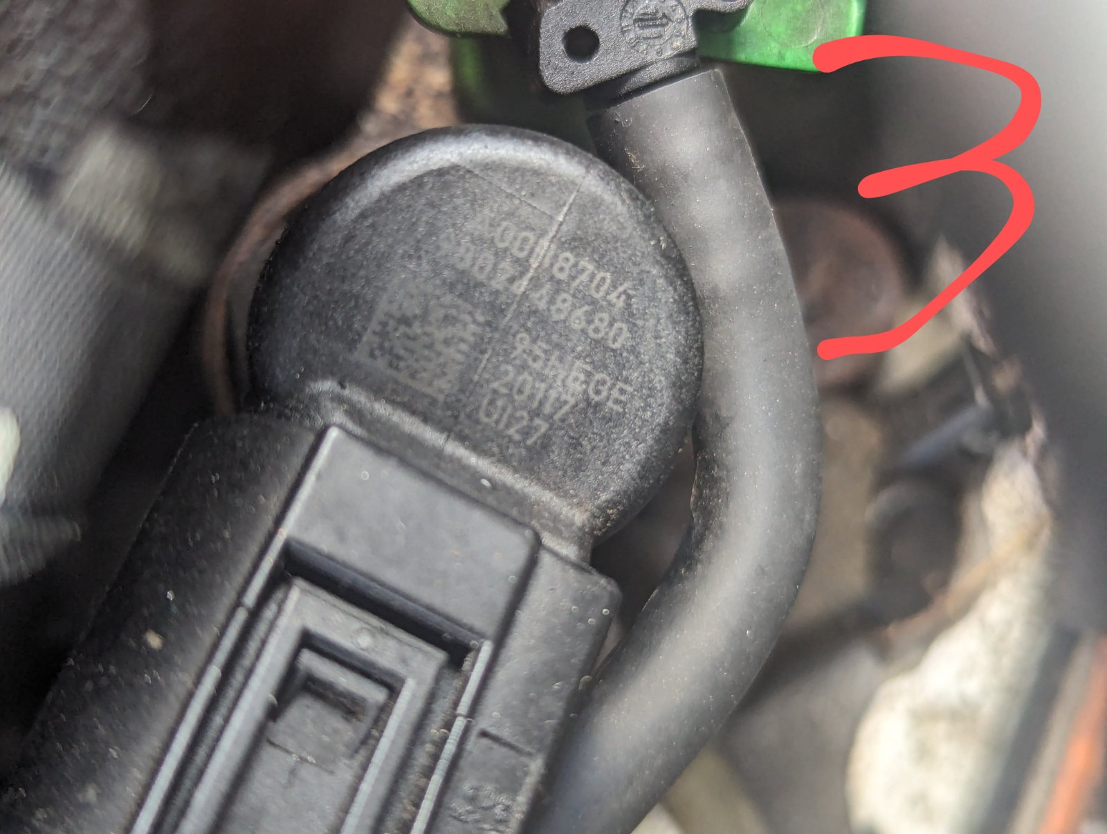

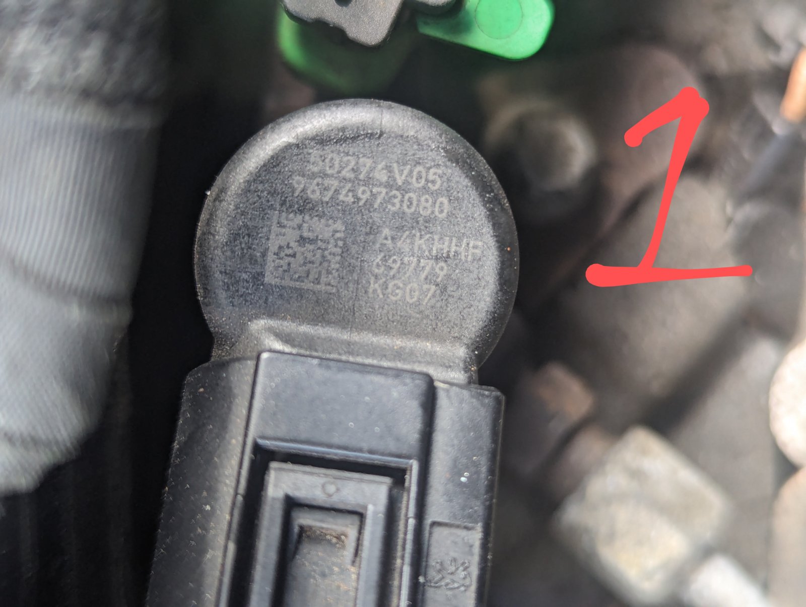

I was going to see about refitting the old injector temporarily to perform some more testing, but all the lettering has completely faded so coding it will be a big issue! I then decided to see if I’d saved the previous code to my Autel device, and upon doing so I noticed some weird stuff.

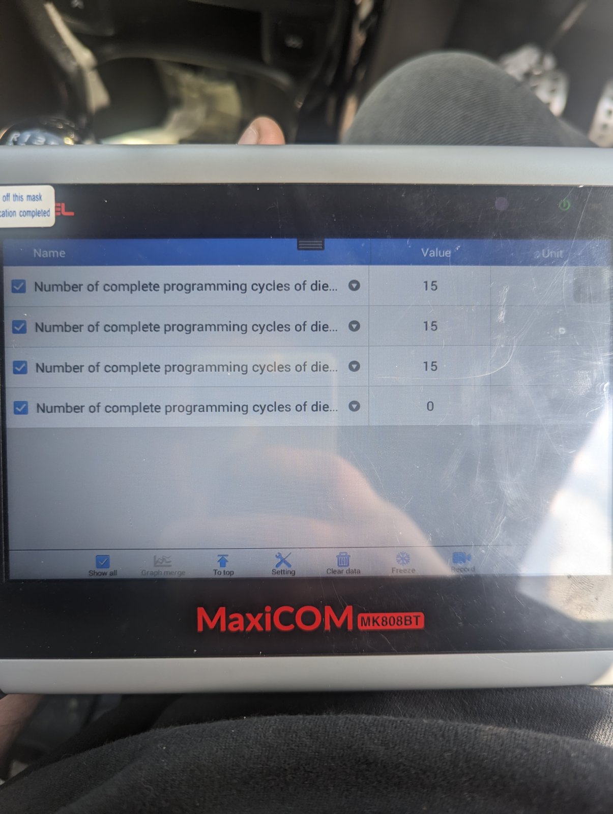

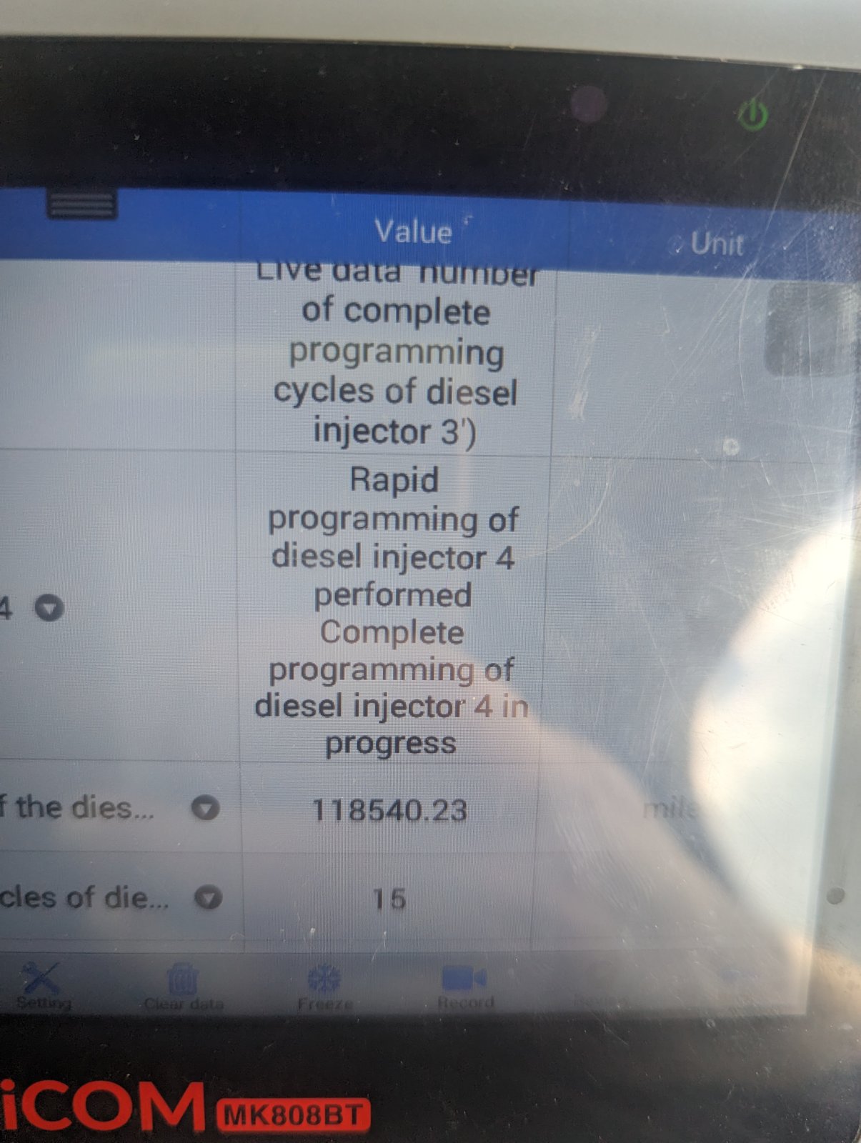

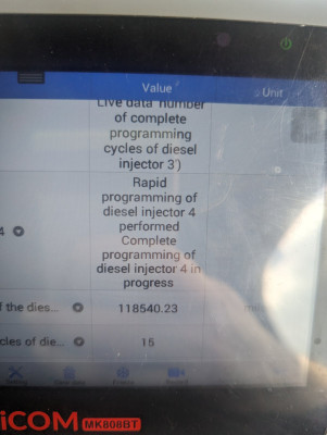

My Autel device reports that cylinder 1 and 2 both have the same injector codes… But cylinder 2 has a different code on the injector itself. Injector 3 (the one that was replaced by a garage) ALSO has a different code on Autel to what is printed on the injector. When looking at live data, I can see that injectors 1, 2 and 3 have all had a complete programming cycle. On injector 4 though, it reports that it’s had a rapid programming cycle but a complete cycle is still in progress. I've posted photos of this below.
Does anyone have the slightest idea where I should be looking? Thanks in advance :)
