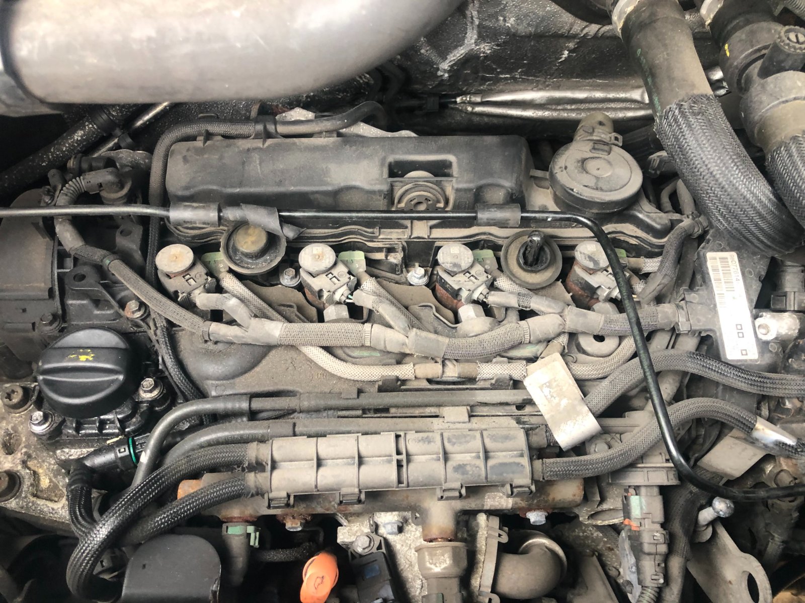

Here is a photo of my engine bay, are you able to point out to me here I should be looking for the things you mentioned in your reply

Excessive oil consumption is very common on this engine and i know Peugeot replace loads of engines for this fault.
Have you done basic checks like the turbo?
