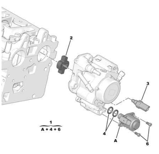

The leak is engine oil, not diesel. (The fuel side works fine, great pressure regulation and engine starts splendid right away so injection is 100%.) It's hard to pinpoint since the oil spreads thin around. I first thought it's the pressure regulator bolted onto the HPF pump but it's just the casualty of the oil leak. The leak must originate from the bore hole through which the camshaft drives the HPF pump. See the attached image: the exploded view lacks the said gasket (which sits between the pump and the head) but it should get your bearings right about the location.

I wonder if a thicker layer of gasket material, either additional paper gasket or just more silicone (or both the old and the new gasket together with silicone in between?), could help there if the side of the cylinder head isn't 100% true for some reason? There seems to be a seam going through the borehole, based on the image. The pump is connected to the camshaft with that coupler so it doesn't matter if the pump sits 0.5 mm further or closer anyway.
