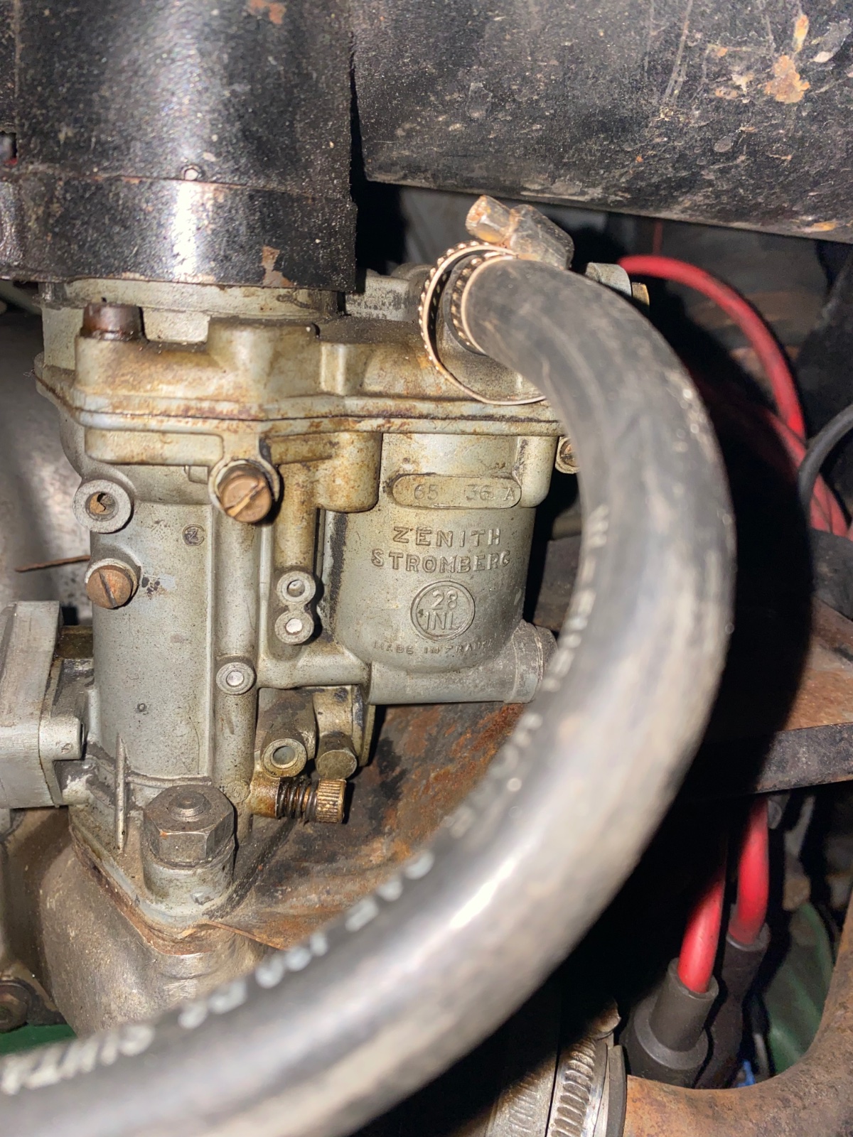

Hi,
I recently bought a 1972 Citroen H Y Van and I’m wanting to give the carb a service. However, I’m really struggling to find a service kit for the carb or even a reconditioned one. The carb has “Zenith Stromberg 28 INL” written on it. I see a lot of H Y Vans have Solex Carbs on it so I’m confused on why mine has a Zenith one.
Where can I get a service kit for one or a reconditioned one? Or could I even stick a solex one on it and if so which one would fit it?
Thanks in advance!

From experience rebuilding classic bike carbs only use OEM or proven parts. The metal parts rarely need replacing unless they have been mullered. Only gaskets and O rings need replacing. Using poor quality jets etc. can lead you down a rabbit hole. An ultrasonic bath is your best friend.

xantia_v6 wrote: 02 Jun 2024, 08:15 This could be your lucky day... https://www.ebay.fr/itm/314515171976?sh ... GTR=1#shId
Well that looks like to be the one. I searched for a good 3 hours yesterday and couldn’t find anything. You may of saved the day, thank you.

Zenith make Traction carbs, as well- my 1953 Traction has an OE Zenith. It's quite rare, but not impossible to find, and the TOC spares dept. do a sort of rebuild kit for one.
It's easier to find a Solex, but make sure that it's a genuine one- I've a lot of fakes (30 years of Tractioning) and they are all rubbish.
