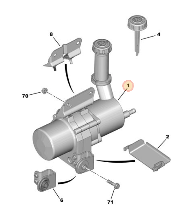

Dont suppose you have part number part number for power steering pump.
Cheers Lee
Cheers Lee
- x 6960
Re: Ds5 hybrid 2011 aux belt tensioner
Just pop up future parts request in the main thread Lee, or I may miss it.
viewtopic.php?t=69962
(1) Power Steering Electro Pump, part: 1612845880, £1,133.22
