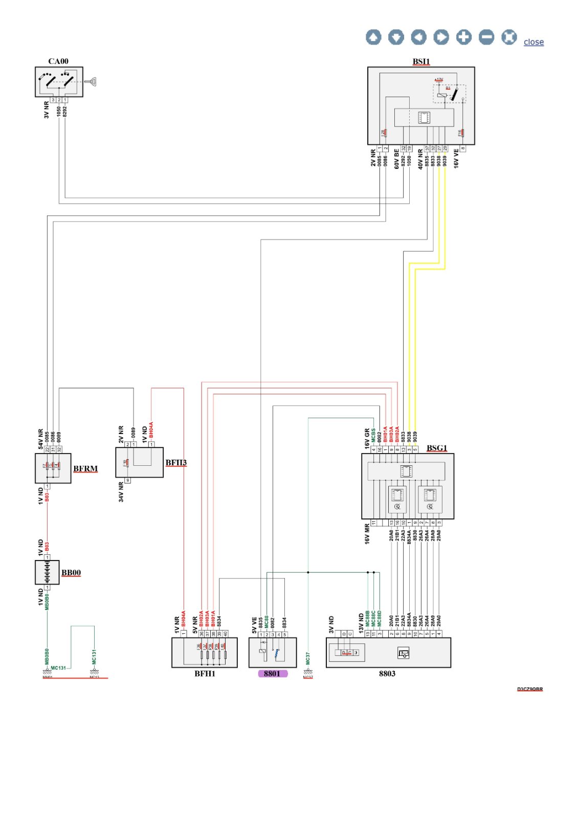

I have a Peugeot 2008 1.6BlueHdi, from 2017, vin is VF3**************[VIN obfuscated, can be read by forum staff], RPO 20880, and i installed an aftermarkt Towbar, now just need to install the wiring for the trailer plug.
I bougth separetly as well the original/official wiring KIT 1688058680, new on ebay, but the instructios/wiring schematics are missing, already contact the seller, no luck so far.
I have search for this kit, and several shops stated that it is compatible with Peugeot 2008... I found as well the kit 1610626280 should be the correct one.
The Kits are almost similar, with the differences:
-The wiring schematic that i got for my car have a Relay - 8801 - Trailer double relay, and the wiring kit doesn't have this relay.
-The wiring KIT doesn't have this relay, and respective wiring - 4 wires total.
-The wiring KIT (no relay) it have two different wires - ZE03 and ZE34, that are connected to BSG1 connector 16V GR, pins 11 (ZE03) and 14 (ZE34), the schematic doesn't make reference to these 2 wires.
Does anybody install already this kit 1688058680 and can share the wiring diagram? This kit should be compatible with several cars Peugeot 208 / 2008 / 301 / Citroen C3 / C-Elysee /C4-Cactus maybe others.
What is the function of this relay, can i just installed without the relay?
Does someone could me help to find out the missing the P/N of the Trailer relay, i didn't found so far, so i can add/modify the wiring kit that i already have.
