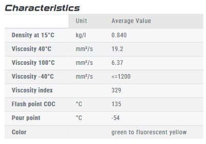

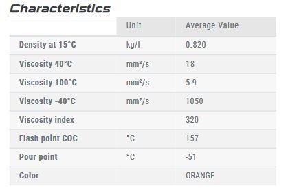

My bet is that LDS was "developed" to be a fluid that was compatible across the range of cars and was a unique "need" for PSA cars (even when labled under a different name by other plastic badge cars.
LDS Spec LHM Spec

LDS Spec
LHM Spec

I note that those are only the temp and viscosity characteristics, but doesn't have anything about the actual oil composition...
Here's some further info for the 2 types from a particlular supplier:
