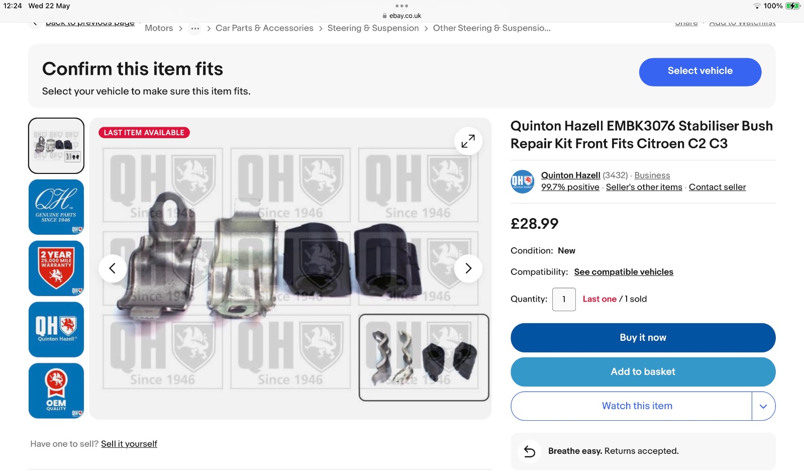

Bought it then bought new front mounts, struts etc. Getting it MOT’d after they’d fitted all the bits. Got a phone call to say the anti roll bar bushes and clamps are toast. Clamps corroded and can’t be reused . Can get the bushes individually but not the clamps. Full kits are available but only for 109 bhp VTS the bar on mine is 21mm all others seem to be 18-20mm
I have contacted companies like QH directly and they don’t have these kits, anyone any ideas where I’ll get them?

Maybe the clamps from the available kits are the same as for the larger bushes?

The part numbers for the clamp is the same for the VTR and VTS so should be the same. I assume the diameter of the hole in the bush is different for different models. Hope that helps.

The clamps for the C2's and C3's (of that era) should all be the same. They should be easy enough to find. If the sway bar diameter is different, then the hole in the bushing will be different.
So it looks like you will be buying the bushes and clamps independently.

The clamps are the same on all variants of the C2, it's also used on some variants of the C3, most of the variants of C3 MK 2 and Pluriel.

Thanks for reply 👍 So kit above should be ok with correct bushes as I think it’s the VTR one?
