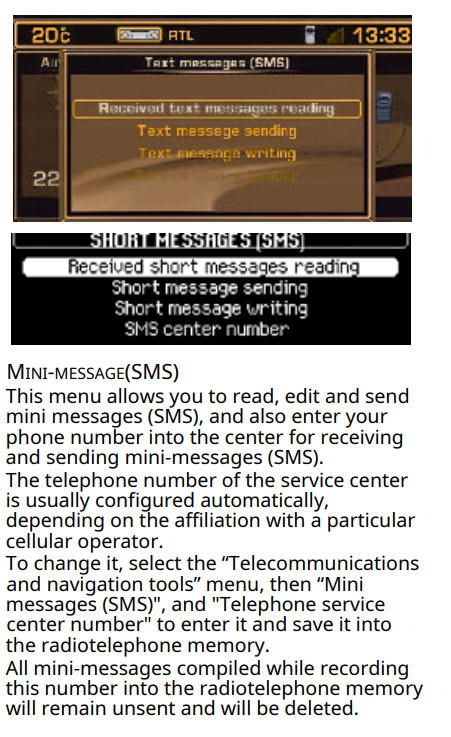

The SMS service centre number is usually accessed from the text message options somewhere in this menu - this is translated, so the text may not be 100% accurate. But if I remember there are other functions like the SIM Pin code and other info somewhere here too.
It may be that the centre number has changed since it was originally set given the age of the unit.

Thanks for the reply, I’ve gone through the menu and I have the following options, none of which let me change the SMS centre:
Received SMS reading
SMS sending - this just shows me the list of messages I’ve attempted to send
SMS writing - the message composer screen
Delete list of text messages
Doesn’t seem to be anywhere I can change the SMS centre

Re: RT3 SMS
Trouble is I remember seeing the setting years ago on my RT3 - it is there, but you may just need to go in and out of the menus to locate it. I just can't remember now!
