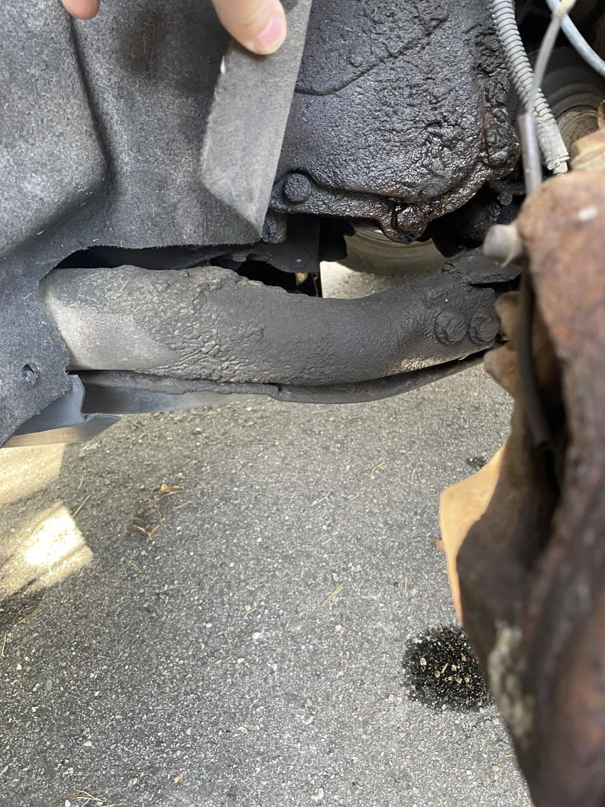

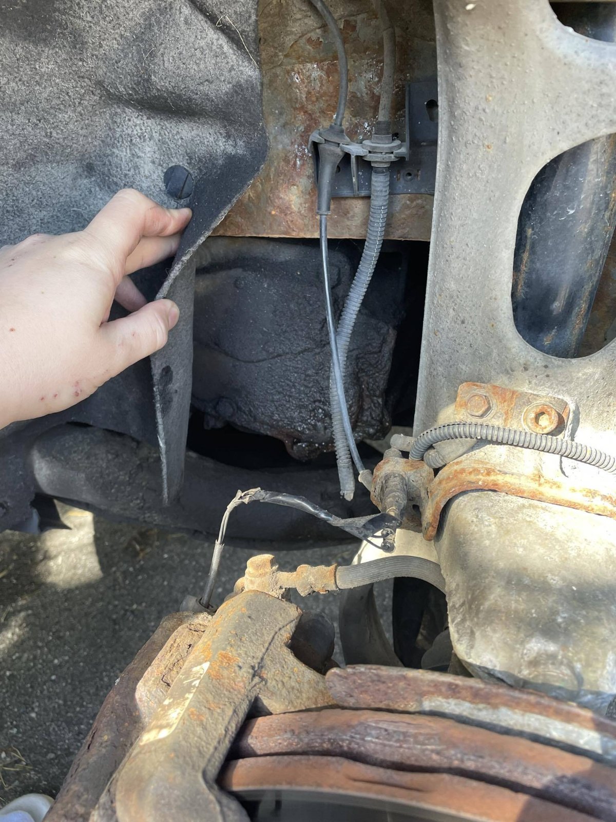

I've noticed that there's oil marks on the ground after I've been parked for a while. Removed the left front tire and noticed it was "bleeding" at the left bottom part of the gearbox. My question is. Can I refill oil here, or do I HAVE to do a full oil change? The refill is temporary till I can get to a workshop in about a month.

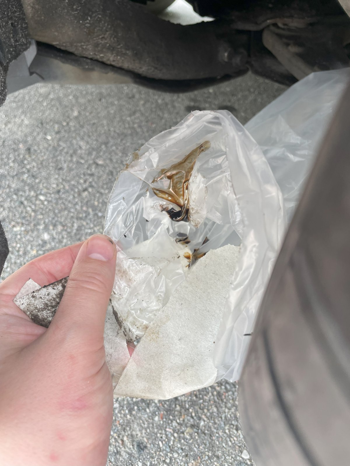

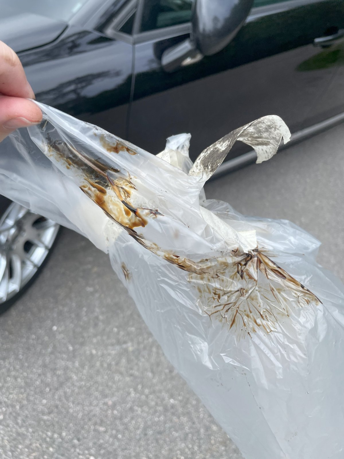

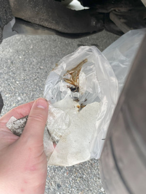

To continue on the original post and oil leakage. I managed to get a sample of sorts of the oil leaking. And the thought that strikes me is that this doesn't look like gear oil. Nor does it have that smell to it.
My thought is. Maybe this is a leakage caused by maybe a blocked Diesel Particle Filter. Could this be the case?

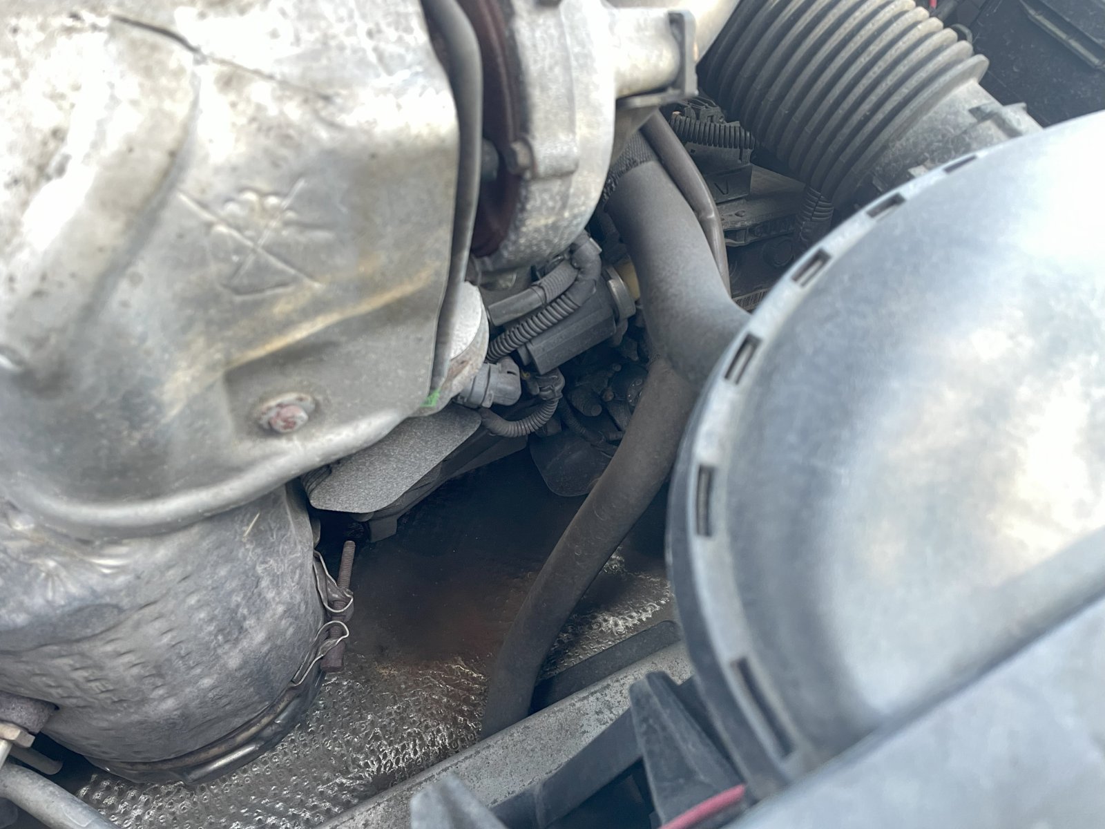

I also noticed theres a "gathering" of fluid in the bottom of the engine compartment when looking towards the gear box.
