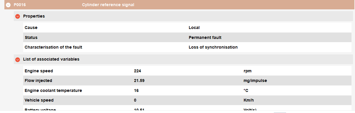

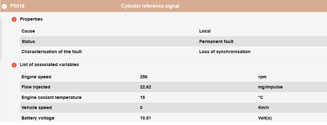

my car cranks but wont start. i went for a 15km drive, it was all good, then i parked the car for 20 minutes, and when i wanted to start it it would just crank but not start. i put the tester on and i get p0016 cylinder reference signal. disconnected the cam sensor, deleted the errors, tried cranking again same code nothing different. would the sensor be the issue? the cam/crank synchronisation parameter stays to no. i have a multimeter but dont really know how to use it. how could i check the sensor or the connector with it? i dont think timing is missaligned since the car worked perfectly before this. great start, had right power, gas mileage was good. i have attached below the error, first was with it plugged, the second with it unplugged. there are no other errors. the 15 km drive was to pick up a mfd display, which i configured to the specs of the car, and it was running good, i tried to plug the old one back in but it would still not start. could the new mfd fry something in the wiring?
