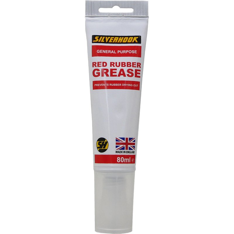

Re: C5 x7 window goes down before up
Try some red rubber grease/silicone grease on the rubber runners.
Now WD4O or similar as that will degrade the rubber.
Thoroughly clean the runners first though.
Thank you! This fixed itmyglaren wrote: 14 May 2024, 18:20 Try some red rubber grease/silicone grease on the rubber runners.
I used the wd40 silicone spray.
Put some along the window seal on outside edge.
Pulled the window back into the car slightly and squirted some in the gap between window and seal.
Then put some on the plastic runner that holds the glass to the metal tracks.
And then put a bit on the tracks themselves, along the edge that the runner runs. (I put more on the side you can't see). This would have been easier if I put it on before fitting the regulator inside the door
Didn't need a lot, but the window moves smoothly now. Ironically it goes up faster than the passenger side now, so i might need to do all the other windows too!
