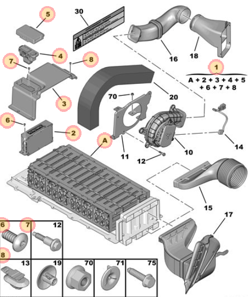

The Traction battery is not cheap and is only sold with the following components shown under (1):
Price is £6,552.00
Only specially trained personnel are supposed to work on these legally because of the nature of the batteries (risk of explosion / fire) and the high voltages involved.
Price is £6,552.00
