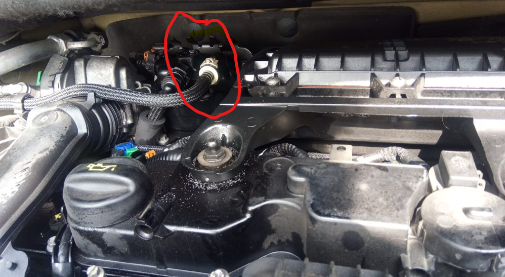

I have attached a relevant image of the pipe
From the recovery report.
The engine cut out when driving. There is a trail and puddle of diesel under the vehicle. Found fuel pipe come off at fuel filter.
Refitted, but the clip looks damaged. The pipe has been secured but we recommend a replacement clip.

The fuel filter does not come with a replacement clip/hose, you will need to get that from a Citroen dealer. If you are going to use the mobile mechanic make sure they are going to replace the clip/hose since if only the filter is replaced you will not have fixed the problem.

It appears to have come loose as I was pulling away from the driveway as there is a trail of diesel rather than any pooled diesel on the floor from overnight
On recovering the car to my home and checking some 8 hours later there are fresh diesel spots in several locations underneath the engine area on the Street surface
Underneath the fuel line that was re-clipped, there is a significant pool of diesel such that it was still wet visibly so like a small puddle caused by a drip
I turned the car 180° and upon exiting there were some small spots of diesel appearing on the street surface underneath the new position of the engine
So now I'm getting concerned that the damage may be more extensive and across the whole bottom of the engine or
That given the fuel line is under pressure it's still leaking diesel and the slow leak is allowing it to travel down the engine bay and fall off at several spots I think this is the likely explanation
I pushed the fuel line in as much as I could and checked that it wasn't loose however on doing so my fingers became wet with a very small amount of diesel that was still leaking diesel and not engine oil
Is it possible that the underside of the engine could have taken damage from a speed bump or something else and this is actually causing it to leak in several places rather than just the fuel line?

There is nothing under the engine that can leak fuel. The fuel has just pooled up on different parts of the engine.
If it is the white release button for the circled white pipe fitting that is loose or not holding. You will need a new fuel filter housing at the least, possibly also a fuel line.
I´d get it towed too the nearest Citroën garage

Thanks for the reassurance that's exactly what it looks like
I have moved the car backwards and forwards into different places and the amount of diesel droplets and puddles underneath has both decreased in number and in size over the last 24 hours
It appears that it is not leaving a trail of fuel as I pull in and out of the driveway
As you suggested what I was seeing is diesel that had collected in the engine bay area It was falling out rather than was still leaking
The fuel attachment appears to be a lot less wet than before

Do you think it is worth me putting a removable plastic cable tie that can be removed using a Flathead screwdriver?
That would ensure that there is a secondary mechanism other than the clip holding the fuel line in place
It would have to be a gentle but tight tie as I would not want to compress the area too much
I don't think that area of the engine bay gets that hot so it should be safe ?
if I were to cable tie the fuel attachment pipe as per the photo above any thoughts?
If you think it may cause issues with any insurance etc then I won't do it

These fuel connectors are all too easy to break, if only the part that holds the thing in place is damaged then a strategically placed zip tie or two might well work, make sure that the connector sits squarely onto the stub, it does not need to be pulled too tightly, a few drops of washing up liquid and some hot water will clean up the spillage.

1) No fuel leaks other than the original venting of the spilt diesel
2) No dashboard warning lights regarding engine
3) No pooling of diesel or anything else under the engine bay
4) Far better fuel economy
It looks like the only problem was a poorly fitted-clip from the last servicing
The better fuel economy is strange - it could be it was drip-leaking before and is now properly fixed
