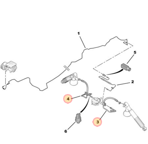

There appears to be some confusion in topics posted regarding the part number for the rear left hand side suspension pipe. Please someone confirm that it is 5270VG not 5270VF as someone (actually several) has quoted back in March 2023 on this forum.
Jay-Bruce
- Posts: 544
- Joined: 20 Mar 2019, 00:30
- x 280
- x 6957
Re: Citroen C5 X7 hydraulic pipes
Both parts are valid Don, but to clear up any confusion:Ceenine wrote: 09 May 2024, 20:32 There appears to be some confusion in topics posted regarding the part number for the rear left hand side suspension pipe. Please someone confirm that it is 5270VG not 5270VF as someone (actually several) has quoted back in March 2023 on this forum.
(3) Hydraulic Pipe (left) part: 5270VG
(4) Hydraulic Pipe (right) part: 5270VF
So 'left' is always the same as your left when standing behind the vehicle, facing the tailgate / boot.
