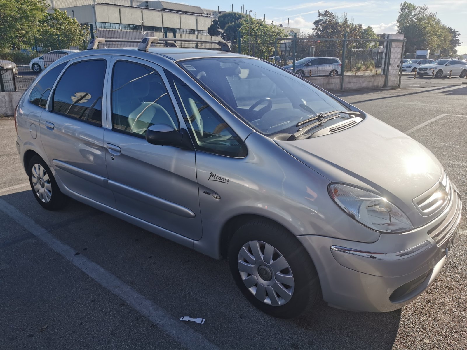

I live in Portugal and today I have just bought a silver 2008 Xsara Picasso. It's our second. We moved here 2 years ago in an Irish registered Picasso of the same year.
I was aware that the AC wasn't working but the seller took it to a garage while I was with him and they diagnosed a leak. I wanted the car as it is in overall really good condition and he gave me a good discount after a bit of hard negotiation (I swore I wouldn't buy a car with faulty aircon as it can reach 42c here in summer so I wanted some cash to help rectify this).

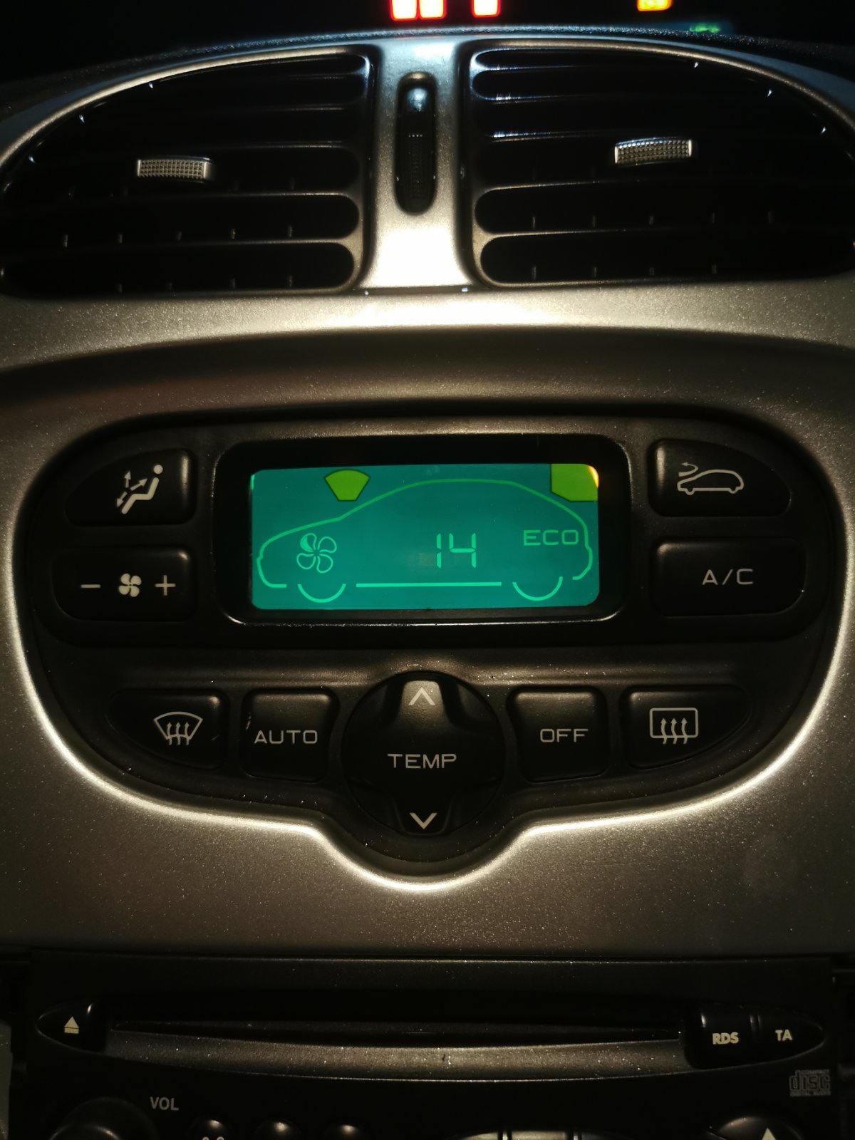

Apart from it not getting cold, the fan is very weak compared to our other Picasso. It is like the max power is similar to the lowest fan setting on our other car.
The displayed temperature can be lowered to 14c.
And I could be wrong about this part as I've only driven it the 250km home tonight, but when I raised the temperature control, the heat did go up, but when I lowered the control, the air didn't feel like it went cool again.

Think of the '14' is more of a setting than an temperature. This is correct for the lowest you can set it.
