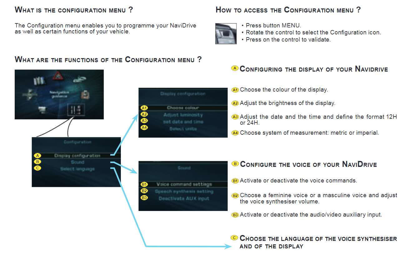

The language (if anything like the earlier RT3) is only changeable from the software CD. It is not a language CD, it is the actual firmware CD. When you select the 'Change Language', shown at 'C' below:
What version of Firmware does the unit have? The latest and last version is 8.31.
